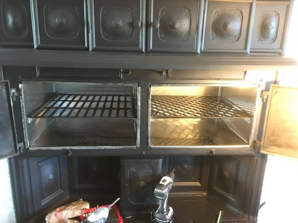

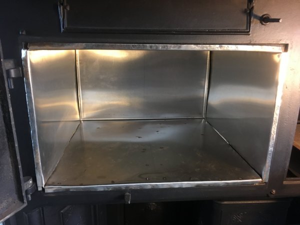

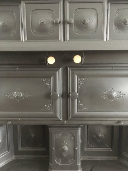

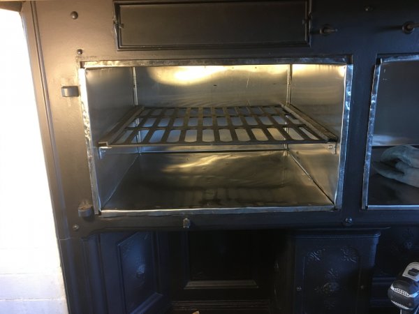

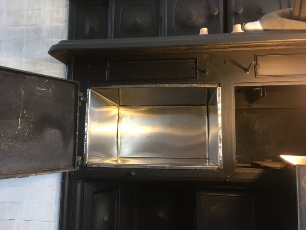

    The knobs fit:

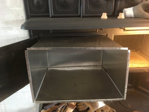

    And the first oven liner box was hammered home:
    4FE6530E-F9BA-4BE5-AB6D-D6CD1084A0B7.jpeg 404447D2-297F-4FDC-83F0-62E12718A27D.jpeg 4F62F567-EFED-437E-8751-14D6B07980BC.jpeg
    It’s far from perfect or professional but I can honestly say I built them, they fit perfectly and I installed them.

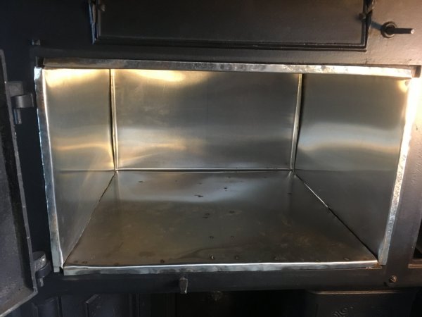

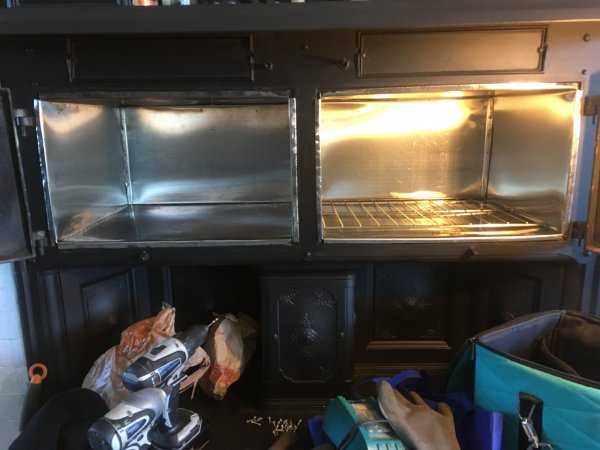

    I got the second box in. I realized I could work them in by hand without hammering them when I slid the second box in.
    I can only call it miraculous. I built these boxes 500 miles away from this stove, in my mom’s basement back in PA. Musta made some accurate measurements for a change! You couldn’t fit a sheet of paper between the steel boxes and the cast iron openings.

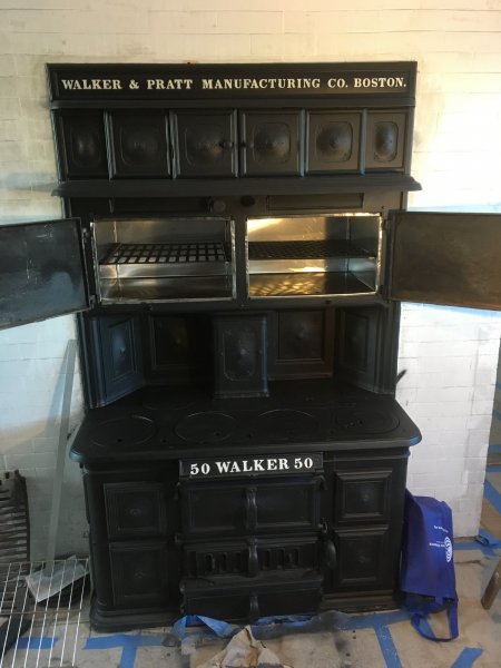

    It took me a lot longer than I had hoped but I’m like a little kid today, I’m so excited this project actually came together as I planned and envisioned it.
    In the past on major projects, it was always a process of going back and repeating steps, because invariably something would have been the wrong measurement or cut wrong. Not so with this project. Everything went so smoothly, according to plan. All the steps just fell into place. I’m getting goosebumps just remembering the whole project over the last 5 months.
    I can’t wait to build the first fire. Gotta do some simple furnace cement repair later this week, but I have a couple more days work in our offices first.

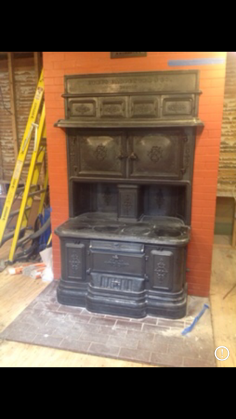

    They’re rare but there’s still a few around, mostly in New England estates and museums. It’s not easy to find information about using them, let alone restoring them. 0A807AF9-B192-49C0-B7EC-943BCA267A71.jpeg A3D5B925-A179-4E59-9418-6B1CBCF6B9B3.jpeg BDC69EE1-9666-4B71-82EC-FE93DD31FD11.jpeg 4A34640D-6873-4E50-93E0-0DDBAF307EC3.jpeg 33B706A3-DF64-490E-AA85-58E4A000662D.jpeg 8BD6E7C9-1FE6-4DA1-9B4E-C41CE9967249.png C49FDBD6-6ABF-44B2-B08A-4DF7BE4D1420.png

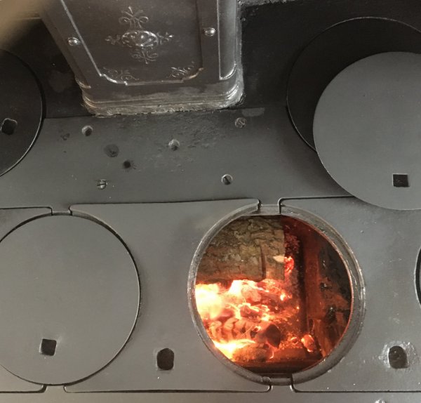

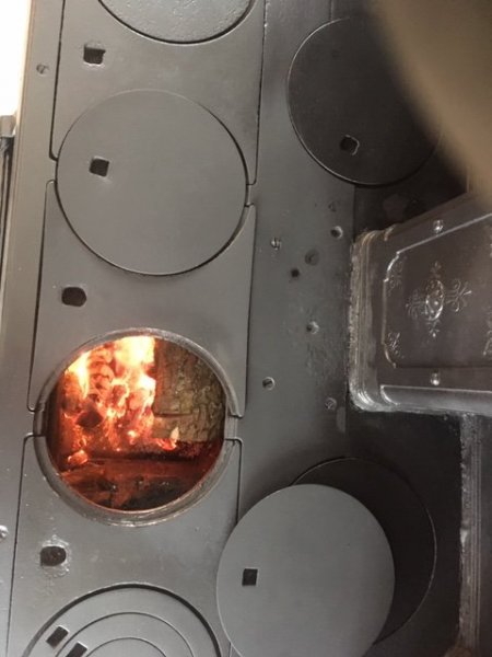

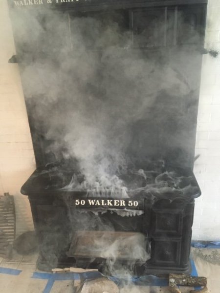

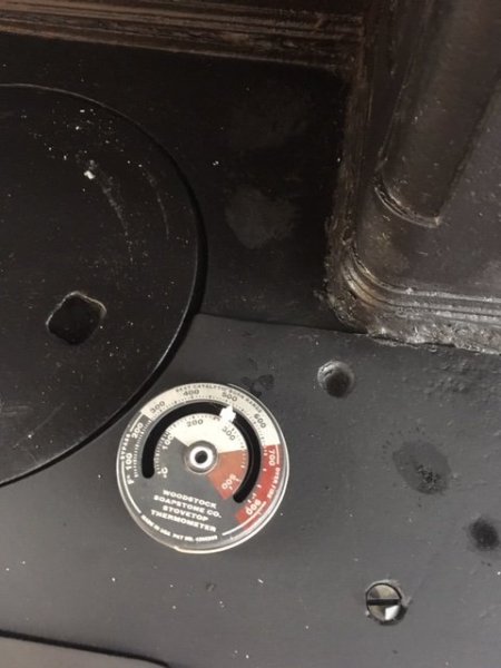

    FINALLY...

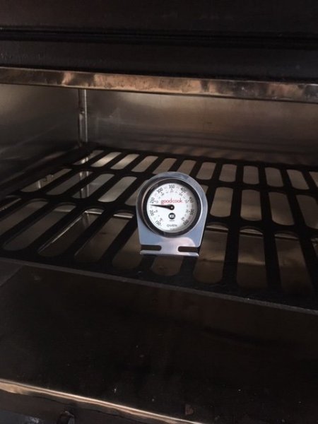

    Started a fire at 9:30 this morning. It took a full half hour to stop smoking back. It was pretty alarming at first, and these was a lot of condensation coming out various areas, but I realized I didn’t have the two flue dampers wide open. But now the stove (cook) top is over 500• and the oven about 2:50 so far. A7233C15-AF7C-43BE-9040-E4DDB5199F5B.jpeg 60E35461-9CFE-4FD8-8D88-D40D0E6CAE9C.jpeg C166BF28-D9F3-410B-996A-AFC491B822CE.jpeg CBC4019C-035D-44AC-B762-4EBC19E4B43B.jpeg FD028A15-4946-471A-BAFF-48316D507537.jpeg
    Gasifier, papadave, Midwinter and 5 others like this.
  18. BrianK
    BrianK
    3,108
    11,115
    West central PA
    I burned a whole Supercedar at the base of the flue before I started the fire to heat up the chimney. I thought that would do it but I still had the dampers partially closed. It’s a tall old manor and this thing hasn’t been burned in decades. I’m sure there a was stubborn plug of cold air in the chimney. It’s is about 28• now but was around 25• when I started, and we’re just now getting some freezing rain.
