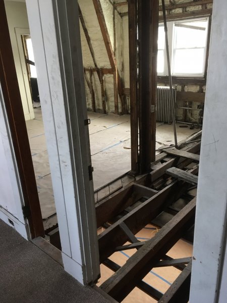

    Now I’m back on the mountain at the manor retreat house. It was 17• this morning, but it has warmed up to the upper 20s. However, while the second floor and attack are fully insulated now, the first floor has no blown insulation yet, and there are numerous holes in the walls where you can see sunlight. (Plus yesterday I picked up my motorcycle from the mechanic and road it 10 miles home in 30• weather, which was a wee bit colder than sitting in this cold house.) 5519A650-C983-42A6-A6B8-19BAAA7CFF50.jpeg
    This is the second floor bath and bedroom where I had originally moved in in August. Not exactly livable space now: FE32DF4A-D607-46BD-980D-9E61C9F37C6B.jpeg

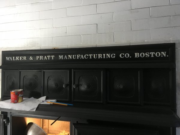

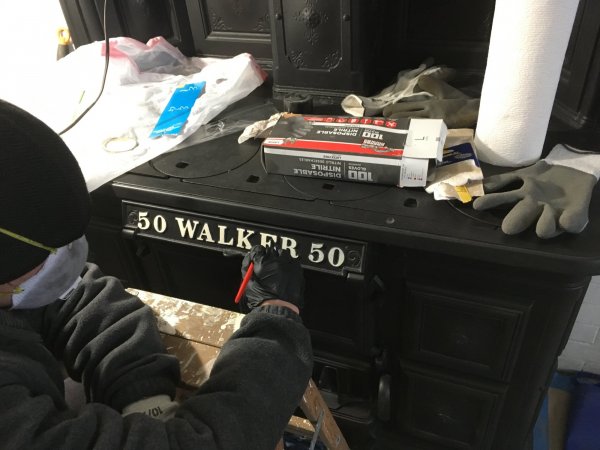

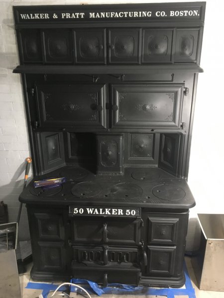

    I’m almost done with the antique cook stove. I just have to finish the oven box supports and repair the assembly that holds the internal draft dampers for the flue. We used high temp ceramic based off white motor/header paint for the letters.
    16108FF1-DEB4-47CE-B225-DF8700B0866B.jpeg FDCA0DA0-1D9C-486E-BFA6-FE12090B0DBA.jpeg 3AE7D9C0-90AF-4FEF-BEE8-1E640B5C1C80.jpeg
    One of the younger guys from our community who is experienced in fine art painting did the lettering for me, fortunately. It’s too fine of work for me to have attempted it.
    As good as he is, there were still areas where the white paint went over the lines. So I figured out how to decant the black spray stove paint into a water bottle, and he was then able to touch up all the white letters with that black paint with a fine tipped brush.

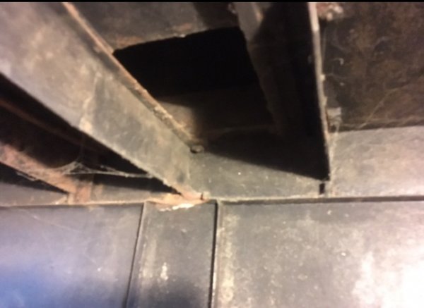

    The two ovens each have their own flue damper, so you can control the amount of hot flue gases (i.e., smoke) passing around each oven liner box, and therefore keep each separate oven at a different temperature to cook different things.
    I spent today fiddling with the control assembly for those two flue dampers, which were partly rusted away, trying to figure out how I could repair them. After a couple hours of failed attempts (and a broken drill bit) I finally figured how to do it, but first I have to cut a couple pieces of metal angles from my heavy steel box scraps and assemble them to hold everything together and functional. 3A62A901-CB12-451C-ADBD-967653FA224C.jpeg 370C507E-46BC-40C0-8475-8CA6412FA105.jpeg

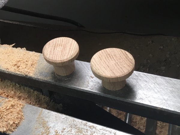

    I’m back at my sister’s in Harrisburg for the holidays. My brother in law WoodTurnerinPA made two knobs on his lathe tonight for me from a piece of honey locust firewood, to replace the missing knobs on the flue damper rods on the antique stove: A11AEB84-8312-4A70-82F6-1A1995FA36E1.jpeg 18614542-41DC-4B1D-9992-500343631236.jpeg
    I’ll paint them black and they’ll go on these two rods sticking out of the stove between the oven knobs and the warming oven knobs. 58E17CE3-AABE-412D-9F1A-53EE3D76A635.jpeg
