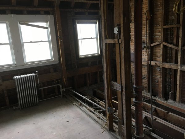

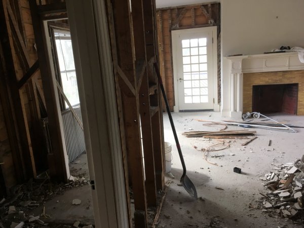

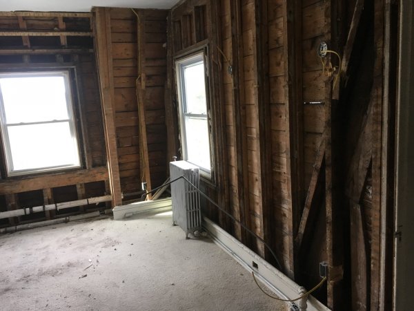

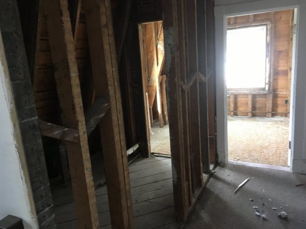

    The real, paid work crew is tearing out all the interior walls in the entire house that are exposed to the outside so they can apply sufficient blown in closed cell insulation. 660865B1-7E71-40F6-A5DF-3359053DCEBB.jpeg E0E0824C-7C20-4B6C-A5F5-19D4B1AE8CFD.jpeg F9CC1ED5-AD3C-4E14-BFD4-4A98E90F0AD9.jpeg A5ECEB34-C81D-45EE-BC86-600C8B0C9204.jpeg A3E84054-61BC-4828-9D84-3FF237C48961.jpeg AA53B4FC-DA01-42DB-9E74-11352F5C84A8.jpeg 6D14D057-407C-4E27-A155-2606DE10898E.jpeg 3A0AEE91-43DE-4A4A-93B2-5BD89212A6AE.jpeg
    They started on the kitchen yesterday and today. And didn’t cover/tape off my stove project. Now it’s literally covered in a thick layer of dust from tearing out all the plaster and lathe. :faint:

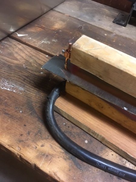

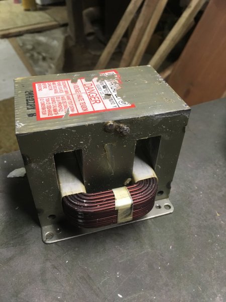

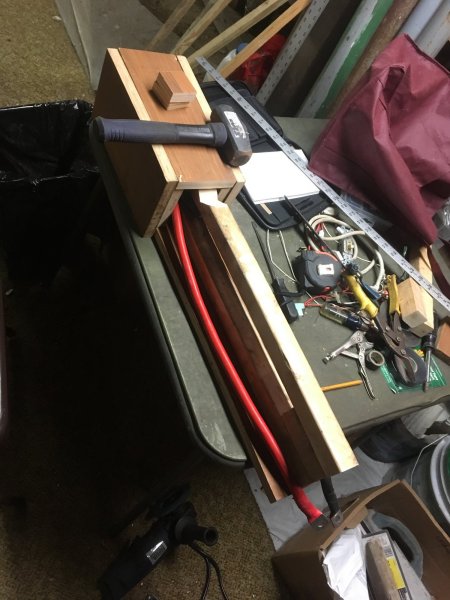

    I’m in the process of building my spot welder from an old 1200 watt microwave oven transformer. The original transformer was a high voltage, low amperage unit. It had a primary coil of a couple hundred wraps of copper wire, and a secondary coil of thousands of wraps of very thin copper wire wrapped around the armature. I had to remove the secondary coil and rewind it with 2 gauge wire so now it’s very low voltage (1-2 volts) but very high amperage (800-900 amps) and it’s enough to melt steel. So I’ll run the two heavy wires to two opposing copper electrodes on the ends of the long 2”x2” arms.
    When you put two layers of sheet metal together between the electrodes and push the power button for a second or two, it welds the metal together in a spot about the size of a pencil eraser. So that’s how I’m going to seal up my stainless metal boxes to line the ovens in the antique cook stove to keep the flue gases/smoke out of the ovens.

    I took it to a friend’s last night who has a lot of experience with electric work, to have him double check all my wiring and make sure all the circuits are continuous with his multimeter. Everything checked out, so we plugged it in and he checked the voltage output. It’s putting out about 2 volts so by the math, amperage should (?) be in the 700-800 amp range, enough to melt steel and make some decent spot welds. E5179B9C-DDE0-46A1-8033-BF864770CE3A.jpeg 8B352F1D-E081-4206-A79A-DE259488A459.jpeg
    Because it’s ultra low voltage, you can touch both electrodes and turn it on and not be harmed. One of the YouTube video makers does just that in his video (but strongly states NO ONE should try that at home!)

    Correct me if I'm wrong BrianK but I thought it was the amps that were dangerous...
  10. BrianK
    BrianK
    3,108
    11,115
    West central PA
    In relative terms, yes, but in this case the voltage isn’t high enough to create an arc from one hand, through the body, to the other hand, so no circuit is created/completed. (I’m not very knowledgeable about electric circuits so I may be wrong!)
  11. brenndatomu
    25,353
    165,139
    Yeah that's basically right, but if you had wet hands/feet, all bets are off.
    0.1 amps can stop your heart, but it takes a little more voltage to drive it...the higher the voltage, the less amps it takes to kill you...and vice versa, to a point anyways...there are a lot of variables with getting shocked and living vs dyeing from it.

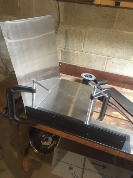

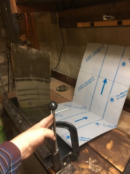

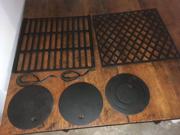

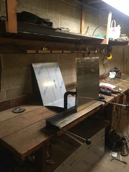

    I finished refurbishing some of the final stove parts and started bending stainless sheet metal for the oven box liners tonight. 4F171225-1C9E-46EA-880E-56D94D000507.jpeg 606DF3D8-CD74-466A-AB59-48085ECC5703.jpeg A1E07D0B-6CFC-4D69-94B5-2AAF62218D17.jpeg 8AF46EC4-3DEE-43A7-9890-5CAC6BFAC29E.jpeg 3B64B972-FBFB-4D2A-ADDA-B51409CCAD8A.jpeg EDAB0B55-9AFE-41BC-B4A8-C9EFDCCC7BFD.jpeg D6B28E79-2A01-4520-9A3A-FB69AD6734F2.jpeg
    Gasifier, papadave, Chaz and 6 others like this.
  13. BrianK
    BrianK
    3,108
    11,115
    West central PA

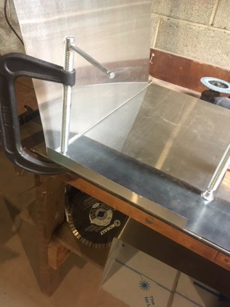

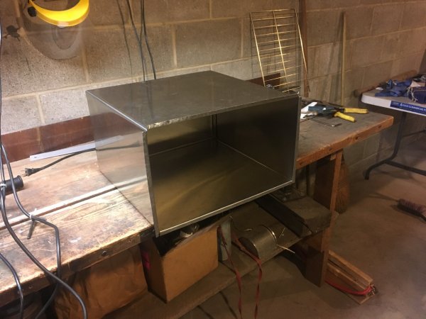

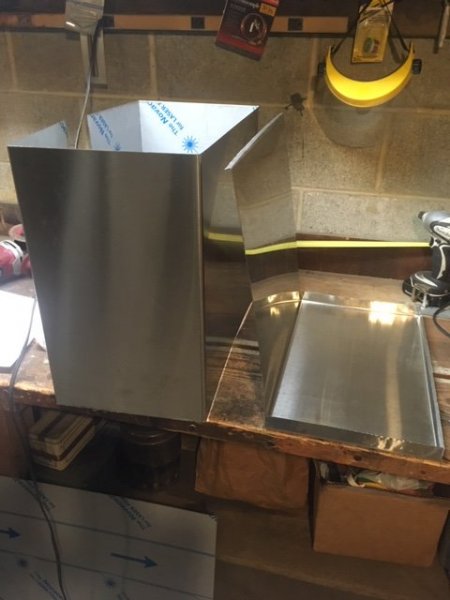

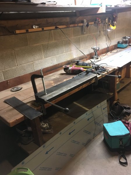

    Making these stainless oven boxes was a lot more of a challenge than I bargained for. I’m about at the max end of my meager metal working skills/experience and they aren’t spot welded yet. C5D90600-B379-4B39-A77D-C99B3FA7ED87.jpeg E2AE4A1B-EA15-47BF-B5CC-F9EEF0727F03.jpeg 2E94878C-EECF-44E4-AC17-E3EDB37229E8.jpeg F7BAB61C-5CD2-4C20-9459-7B919B0BE824.jpeg 5CA29D24-83CA-4386-8B93-EE4A15EB9337.jpeg

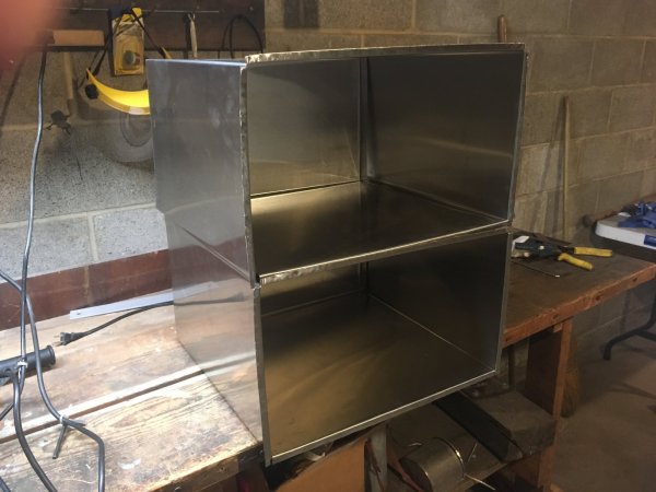

  14. BrianK
    BrianK
    3,108
    11,115
    West central PA
    The cutting and bending is complete, thankfully. Now I have to try out my spot welder tomorrow and seal the boxes up. 21FB2904-1236-403A-9664-4510897F317A.jpeg DEAD50DD-45B9-4E2F-A008-233080D4B561.jpeg EF5B42E8-6C93-40C6-9E87-9479EA2CEFAD.jpeg

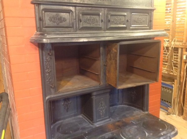

    Thanks! Here’s the type of original oven liner they’ll be replacing: B042D314-5C81-4AB3-B08A-C5717864F91F.jpeg

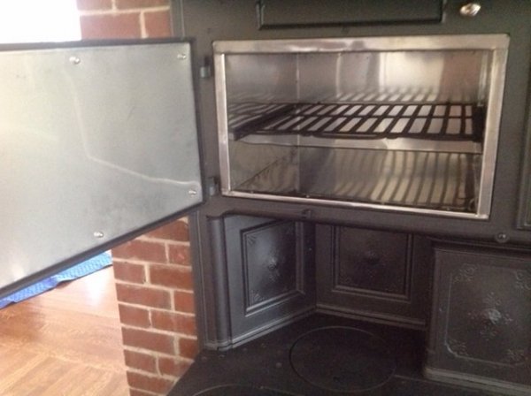

    Yes, but only one, not two. I built the boxes out of 24g stainless but I have a piece of 18g to build the rack supports.
    These boxes I made aren’t as tall as those pictured above. More like this one: 08A5684C-2604-4FBE-8A1E-9FEA8F667F43.jpeg

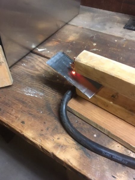

    The diy spot welder actually works!!!
    I can't tear the weld apart, even with pliers.
    72E08EFD-BD06-474B-820F-EBD4552135DD.jpeg AAEDC8D9-B656-4C3C-A818-2E8A75D0D489.jpeg 2AE661F3-C136-46D9-BAC7-F1D5DBE3C788.jpeg
