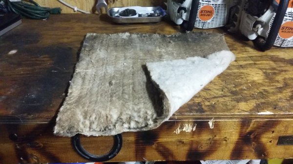

so if I put a 1/2 inch of roxol insulation on top of my baffle plate thingy would it make my jotul F3cb run better????
This blanket helps keep under the baffle hotter (secondary combustion), but leaves plenty of room above it for the stove top to exchange that heat via my convection deck.. I got it off of eBay Dave. I can try and find a link in a bit. I have a few other PM's to get to real quick.
Moving the air control lever does not change the amount of air passing through the stove, it just changes where the air enters the firebox. Noncats move lots of air.
I just remembered I had another piece. I bought 1" thick and split it after I found it slowed the exhaust to much. A 1/2" doesn't bother the 30 at all. If you'd like it? It's yours bud. Just PM your addy (again) and I will get it out this week sometime. Already precut . It is not a perfect fit as far as width. But you want to have the board gap in the middle and center the blanket. Missing an inch on the left and right side of the bkanket just helps installing it. Because it is kinda a PITA. You have to remove the 2 front burn tubes. Then slide the blanket up (carefully) on the boards.
