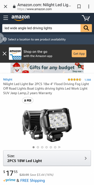

    What lights are you getting? I bought a pair of LED lights for my kawasaki, and I only wired up one, and left the other original halogen light on the other side since it works. Holy schnikeys is that led bright, and less than half the watts.

    These are the ones I've got. They work great. Screenshot_2018-12-15-17-24-44~2.png
