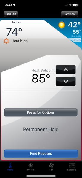

    A screen from the app, a little Windows 95ish:

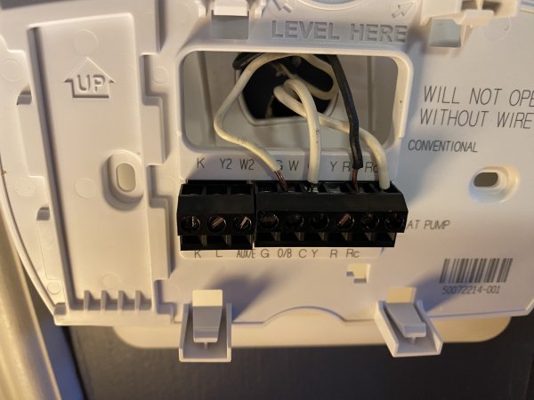

    Here’s how it’s wired. The black and white wires with the exposed copper are from the stove, the other two white wires are from teh 24v transformer:

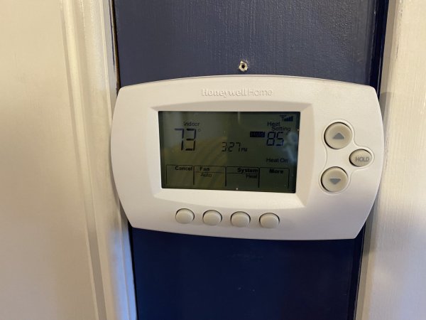

    Mounted up and running the stove:
    Not a bad solution! This unit was pretty reasonable at $60 and change. Happy to have the stove operating on a working unit again.
