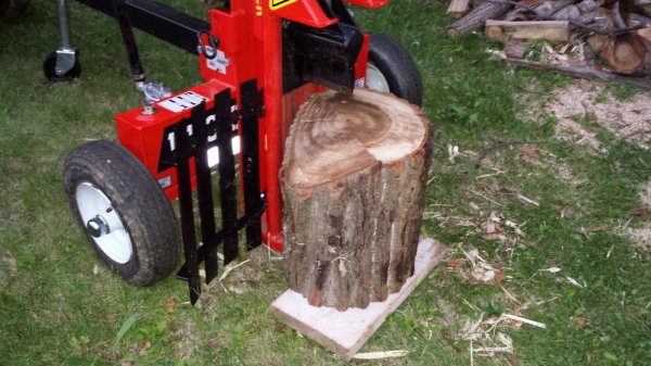

    Yeah, if the board wasn't there the round wouldn't stand on it's own, it would tip forward , you would have to hold it up there until the wedge makes contact.
    Board is real close to thickness of the splitter foot

    Now I'm digging what you're knowing ! ;)
    Gonna give that a try :)

    nice idea,i saw a picture years ago where someone way using 2 or 3 pieces of pipe that were equal to the splitter base in height or just a bit taller and they were used as a work platform and rollers ,i tried it and it works great ,been using 3'' plastic conduit and its holding up well,this is very helpful with very large rounds.

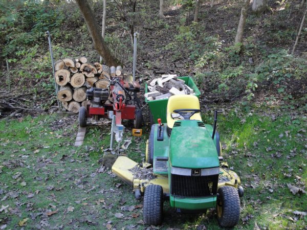

    I have been splitting and putting the pieces into my trailer for years. Saves on the back. I use my Work Mate table while splitting to help keep wood I am working on off the ground. splitting setup1.JPG

    Most definitely the newer splitter tend to have a smaller butt so placing a plank or something like HD does makes a lot of sense and does make things easier.

    Yea gonna ty it
    Was on uneven ground today, & on hooked already & hooked up the big trailer
    , hard to move it around on frozen uneven ground by hand
