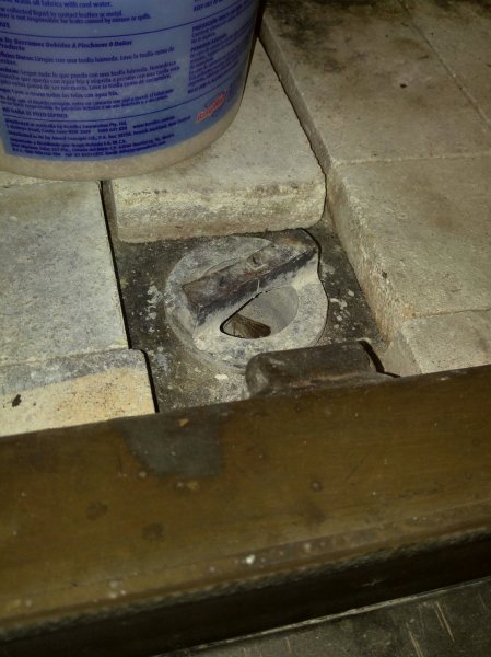

    I never use the ash pan and unless I'm giving it a deep clean I leave the opening covered in ashes. It may not be sucking air,but I feel it is. I have thought about sealing it with door gasket cement since I never use it.

    This.
    Clean things up good then make sure the plug is seated well, bury it.

    If anything the bottom one should be higher. Sumpin ain’t rite

    When I'm burning I never dig the ashes out of this pocket unless I'm giving it a good cleaning. Just curious if anyone else has a set up like this?
    I never use it. It's easier to use a shovel and a bucket. It's not a tight fit so not sure if it's sucking air.
