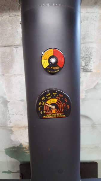

    Just took this pic last night.
    Flue temp. Probe therm vs mag therm.
    This was shortly after a reload. Cat engaged but air still at 50%.
    225° vs 450°

    The magnet and the probe, are reading about the same. I've not had an issue with the flue temps getting over 400 yet. I know it will change when the weather gets really cold. The cat probe is still alive. I bet the probe takes more of a beating with hardwoods.
