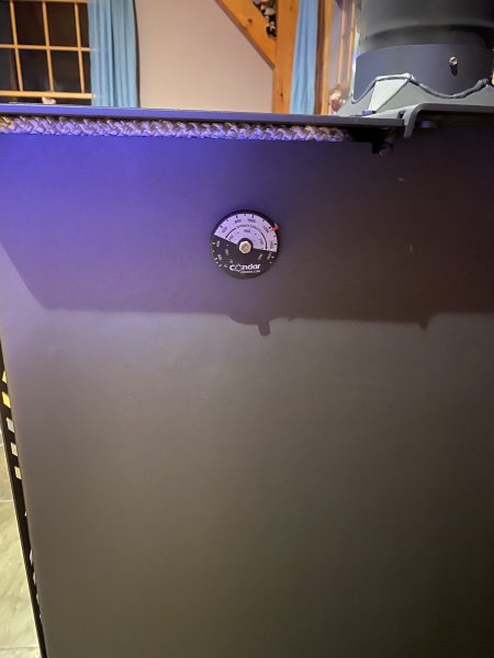

    I got my Condar probe tonight and installed it. Cold start. Tried to engage CAT at 600, didn’t climb after a few minutes. Tried to engage at 700, didn’t climb after a couple minutes. Engaged at 800 and steady climb to 1000. Then I set the air control. Don’t know exactly what the stove temps were but I think pipe around 250 and STT around 325.
    I’d recommend one of these for anyone. Can really see what the CAT is doing.

  14. Troutbum
    Troutbum
    Jan 13, 2021
    164
    331
    Winchendon, MA
    Condar probe

    Seems to me if the probe was in the active range, then the cat should light off anywhere in that range. Anyone have an explanation?
    Are you able to control the stove by the stove air adjustments to where you want it now?

    I think it may be because my CAT is older and because of that may need higher temp to ignite it? I think I’ve heard guys in here talk about that. Once I engaged it and I saw the temps on the probe rise within the first few minutes, I seemed to be able to set the air control and control the fire. Like I said, when I engaged the CAT at 800 the pipe was 250 and SST like 325.

    If I understand correctly, "engaging the cat" on the AS is "throwing" a lever. So does this mean you threw the lever to engage the cat, the temps didn't rise so you threw it the other way ("off" I guess?)? And then repeated this a time or two, till you threw it the last time and the temps on the cat probe rose, so that meant the cat was "engaged", or working? That all seems so wordy and wrong but I'm not sure how else to explain it.....
    What is supposed to be the "active range"? I assume it is obvious on the temp probe, but I can't tell from the pic.

    Yes Eckie. I attempted to engage the CAT twice by closing the bypass flap/closing that lever. The directions on the probe say that if the temps don’t climb steady within 2-5 minutes open the bypass and try again. Then, when the temp rises, you can set the air to what you want for the desired output.

    The active range is about 700 to 1700

    The temp that I find on the Condar that consistently ignites the CAT may be dependent on the distance the probe sits from the CAT too. I think mine sits around a half inch away.
