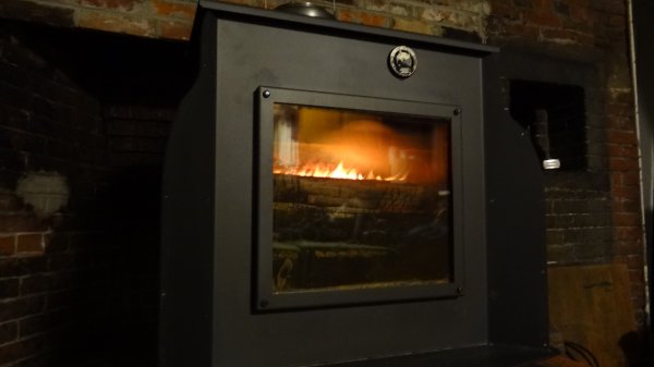

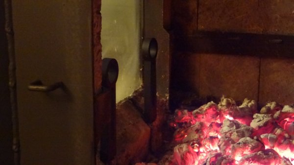

    I guess some of it is a sense of proportion, and some a sense of function. Looking back, we are not getting wood on the glass, even with the shorter andirons, so that leaves it mostly in the court of aesthetics.
    Note the metal inside the firebox, framing the window. It comes back into the firebox the same distance as the back of the andirons. Plus there is about 2.5" more firebox width on each side of the frame. Ken says these pieces are there intentionally to help keep splits off the glass, and it seems to work. DSC05544.JPG

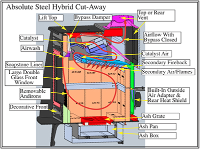

    Sides and top? Looks like the bricks go most of the way up the sides. What protects the top of the front above the glass, and the stove top, as those secondary flames and heat hit that area? Can you get a pic from that area, back toward the flue exit, or describe what the flame path looks like? I guess once it gets to the cat, it's a different story. What protects the cat, BTW? If the plant wasn't 1000 miles away, I would go out there and look at one. :(

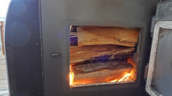

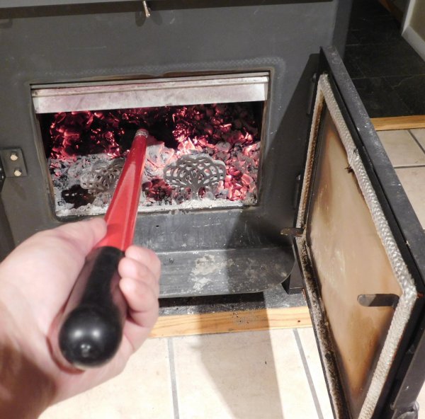

    Well, here is what it looks like:

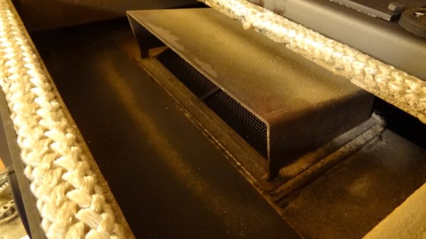

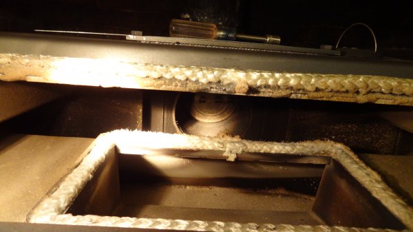

    Did the graphic that fortydegnorth posted, above, help? Next time we slow the stove down I'll try to get some pics. The top lid has a heat shield attached to the underside, and there is a removable shield directly above the cat (it protects the stovetop from the cat).
    Oh, here's a pic from when we first got it that shows the cat shield and the top lid. DSC05442.JPG ...

    Yes! I had seen the one for the PH but not any others. With that, and your pics, it's clear what's going on. :)

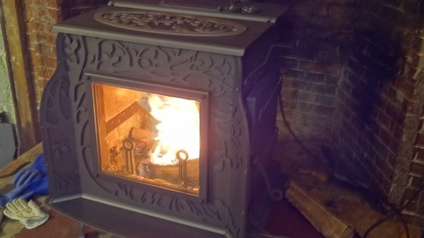

    New paint job on the artwork! It is getting pretty high wife approval ratings...
  15. HDRock
    17,262
    60,487
    That does look better.

    While cooled off for replacing the artwork, I checked the stove over pretty carefully. There is no sign of damage to the high-heat parts like the cat scoop, shield over the cat, etc. The cat was so clean I did not bother to vacuum it - this is at about 1/2 cord. Probably having the key-damper is helping with this some; normally we would have had to vacuum the PH's cat by now.
    Here's a couple pics of the internals...
    Cat and shield removed, key damper visible in the stovepipe.

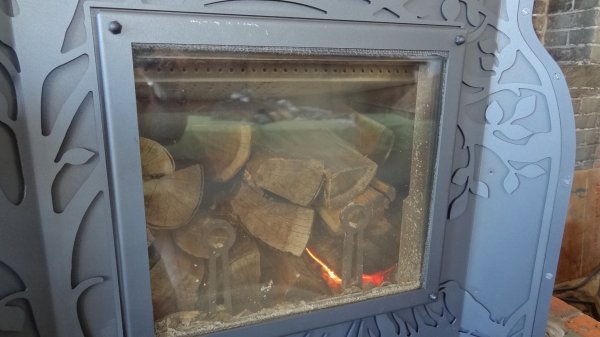

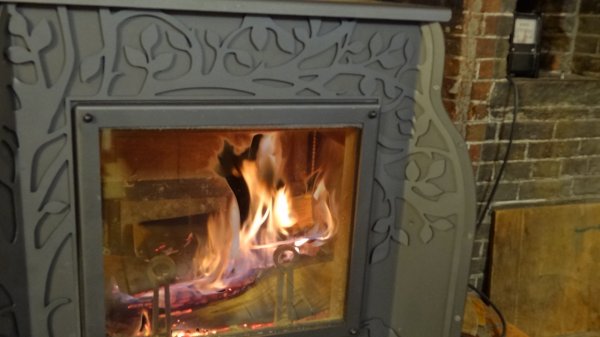

    A couple of pics for a cold, windy day...

    Wow that's a good N/S stack! What is the cut length of those pieces?? This will be an interesting test.
