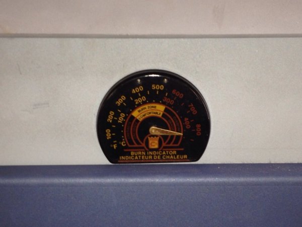

    Temp goes up at start, levels off for hours, then descends.
    Follow the needle on the magnetic temp gauge in this 16 hour locust burn, as well as the secondaries. That hot spot on the front of the stove above the door tracks about 100-150 degrees above stove top temp when its in the yellow zone (about 200 degrees above STT when it pegs at the start of the video). Every 4 seconds is about an hour of the burn cycle:
    Here's the magnetic thermometer so you can get a better idea of the temps in the video:
    I don't wake to STT at 450 very often. Its usually around 300. But this stove at 300 is still throwing off a lot of heat.
    I think the Progress Hybrid would maintain a more level temp overall. Though this stove has a soapstone firebox, it does not have the soapstone cladding that retains and releases the heat over longer periods. It makes up for that with a larger firebox and the ability to dial it down to a longer slower burn. And frankly its more affordable.

    If you watch the locust burn time lapse video closely, the magnetic thermometer is reading in the top half of the yellow range through 32 seconds in the video, which is over 8 hours into the burn. It stays within the yellow through 44 seconds, which is over 11 hours into the burn. Most of the heat comes off the top front of this stove, not the flue collar area.

    Wow, it looks like the gauge is pegged in the first hour, then takes approx. another hour to settle down to a less than ballistic burn. Is that because of your desire for high heat early? If that's the reason, no problem. However, if it can't be controlled at the start, then I need to continue my search or go back to BK. Just trying to clarify.

    Yes, I left the air on high to heat the place up at the start of the burn. If you watch it on YouTube you can see the position of the air control lever at the bottom left of the screen. I can shut it down to a black box by shutting down the air completely even from a nuclear burn like that.
