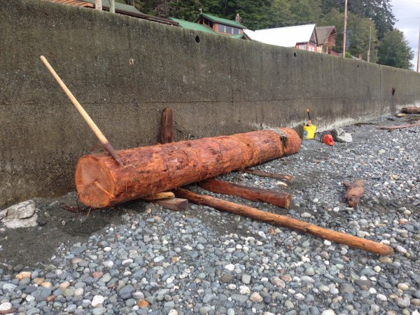

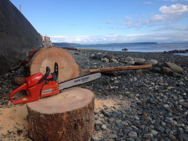

    Last week's high tides brought all kinds of great logs. Here's the first one I've been working on.
    My chain is dead after cutting 8 or 9 rounds off of a log this size. Is this normal? Is there a general consensus of the best way to sharpen a chain in the field? Thanks!

    Nice find! :thumbs: You can get a bar clamp that you can drive into a cut-off round, and then hand-file if you are good at it.

    Nice Log and Nice looking splits too! Nature of the beast especially with dealing with rock like that. But a tool such as Woody Stover shows and a file.

    Nice log. It's even already peeled for ya!

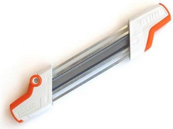

    The bar clamp is essential, and Stilh makes an easy to use file with guide.

    Its all that grit and rocks stuck to the wood. That will kill a chain ASAP. Maybe try brushing it off with a stiff brush or wire brush.

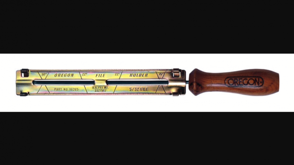

    I like a file guide. Oregon/Stihl style. Cheap and effective.

    Give it a shot. Less than $9 at my local WM. Stihl brand costs a few $'s more. Both work fine for me.
    The guide sets the depth of the file and shows you the angle. Not much left to see other than to check if you've filed enough to get the chain sharp. When I free hand a file, works great for a couple/few sharpenings. Then things (depth/angle) get off. Go back to the guide and its obvious. Sure works for me.
    Then set your raker depth, every few sharpenings.
