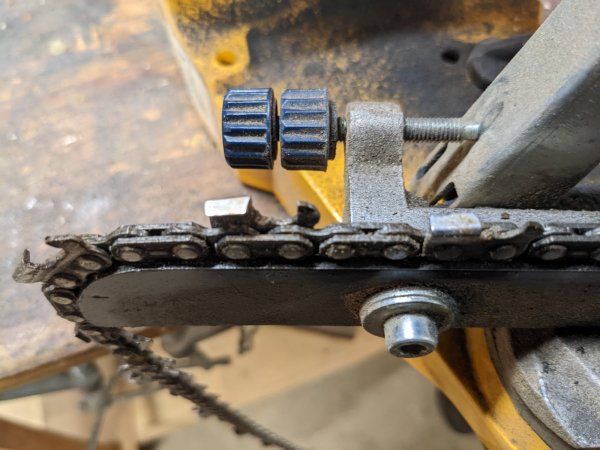

    PXL_20221126_002317049.MP.jpg Sharpened a chain for a firend tonight. Wow.

    Top plate looks like milling angles.

  3. Chvymn99
    19,344
    99,844
    I'd say its a tad bit dull... He'll be smiling seeing wood chips coming out instead saw dust...

  4. buzz-saw
    buzz-saw
    Jan 31, 2020
    4,034
    23,124
    Ct.
    First thing I noticed as well. Very little angle there ; looks close to a 10 degree milling chain compared to a normal chain in the 30 degree range.

  5. chris
    chris
    Oct 9, 2013
    3,063
    10,608
    SE WI
    cut about 25 ft of that wood from New Zeland that is full of silica and that is about what a chain will look like. Rounds off carbide tips also and makes round humps on a steel plate saw blade. If You want a wood deck that is impervious to just about everything that is the goto stuff.

  6. Camber
    Camber
    Nov 4, 2017
    1,660
    11,205
    Montana
    I don't want a deck that tough. When customers ask me to work in IPE the price going screaming through the roof. Chopsaw blades last very very little time.

  8. Ralphie Boy
    Ralphie Boy
    Oct 25, 2014
    4,119
    28,709
    Rabbit Hash, Kentucky
    Anything left of the chain when you finished sharpening it? :eek:
