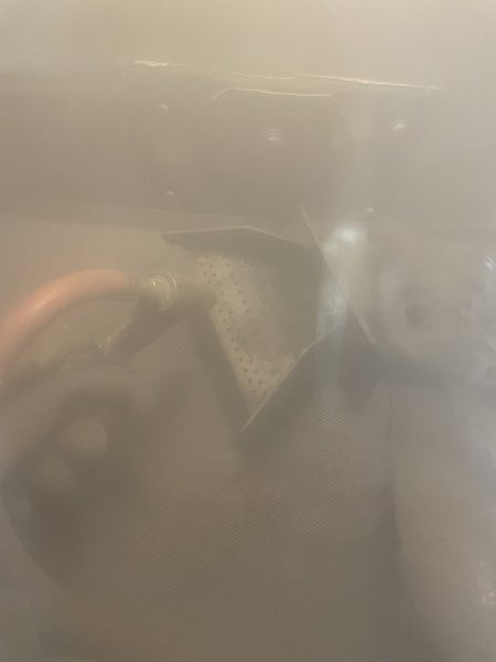

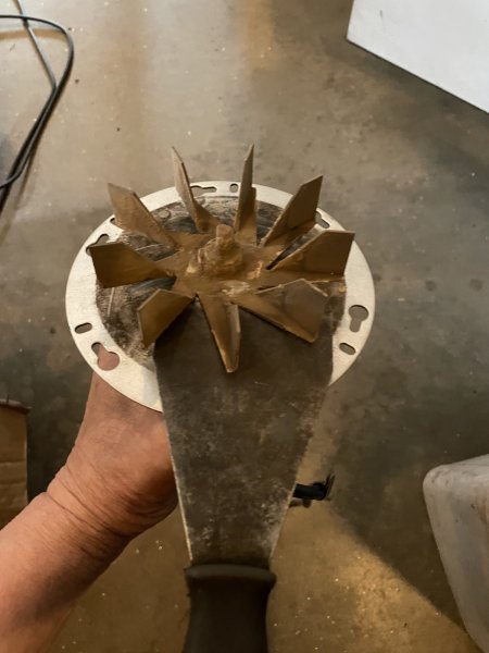

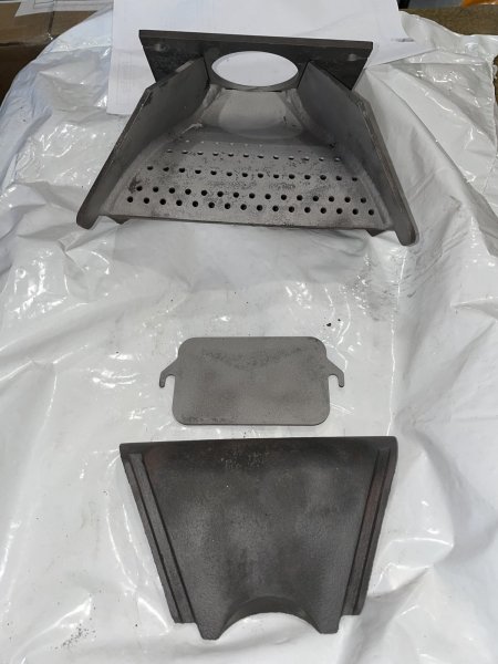

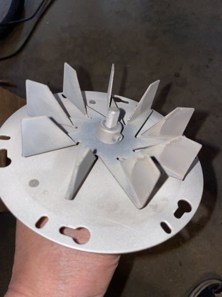

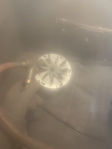

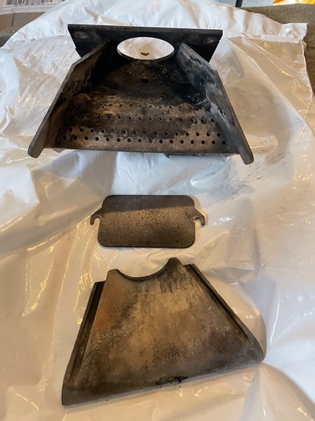

    They can get real nasty with hard black carbon!
    A quick pounding with 90 PSI and 25 CFM seems to work quite well. :)
    Anyone else try this?

    Don, myself, I'd be concerned about getting the oxide in the motor bearings on the draft fan. Have a blast cabinet as well but never considered doing that because of the AO geeing in the motor bearings.
  5. don2222
    don2222
    Nov 10, 2013
    3,263
    4,422
    Salem NH
    Good point, I lubricated the motor afterward and it seemed fine but it may be better to tape off the shaft.
    Have you tried the blasting cabinet on the burn pot? I am going to try it on the BBQ grill grates?
