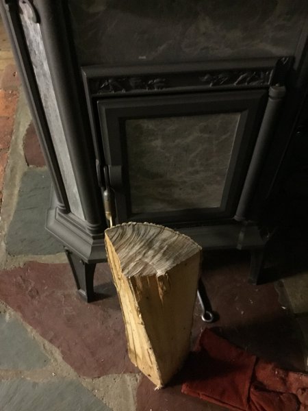

    Wife was cold tonight, but only 48 outside. Cruising at this point with little flame in the firebox.
    Here’s a typical split for us...
    No visible smoke from the chimney, as determined by the flashlight check. But there was a truck with a trailer on a neighbors land where there shouldn’t be. Funny what you see when you go out in the dark.
    papadave likes this.
