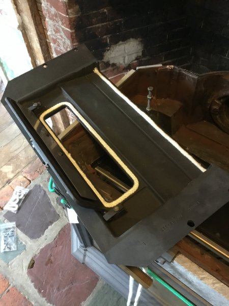

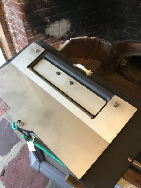

    Nothing like a change in the forecast to get me motivated to finish rebuilding the stove!
    There has been some improvements to some of the stove parts, with additional shielding, like in this pic. This is shown upside down. The rectangle is the bypass door. All this stainless is offset shielding that our original parts didn’t have.

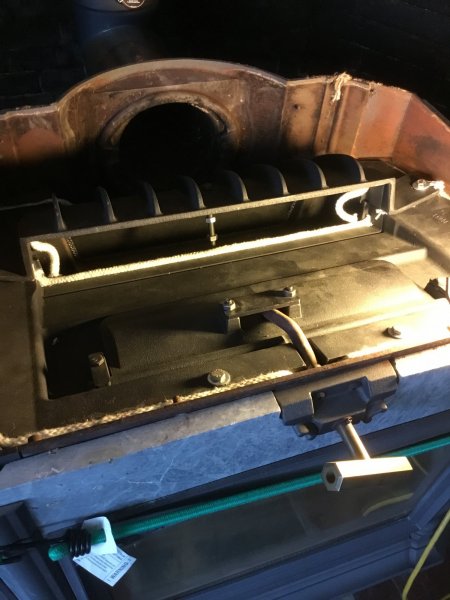

    Here it is, flipped right-side up. The parts came with quite a bit of the gaskets pre-attached. The other gaskets came in individual bags with notes written on them describing where that gasket was to go, and other instructions, such as trim to fit. (You can see an example on the floor in this pic. )

    The cast iron top, not including the griddle or stones, is 42lb. This stove is stout! It got a new gasket, and bolts on with rods at each of the four corners.
    On the rear, we installed a new damper control. Anyone with the original will know how it sticks a bit, making fine adjustment difficult. I’ll be interested to see how this one works in comparison. The openings were not re-designed, so it still lacks the graduated control one gets with the IS and AS.

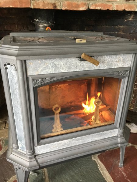

    I’m doing a few small fires to let the cement cure.
    Overall this was a straightforward process. I took pics as I disassembled to help with reassembly. Things went well, although I missed putting cement on a couple of spots on the rear air control, so I tore it apart again, recleaned it, and did it right.
    I have gaskets for the door and ashpan door, but will get to those later this fall. All said and done, I’m pleased with how it went.
