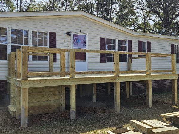

  6. T.Jeff Veal
    29,511
    188,871

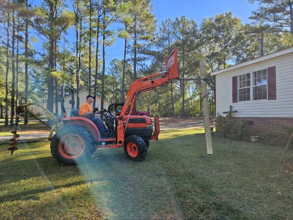

    Yes sir, they are. 6x6x10'. Hard to believe the difference in weight between those and a 4x4. Couldn't have done it without the 'Bota. 20619.jpeg

  11. T.Jeff Veal
    29,511
    188,871
    Both are built here. That is a double wide mobile home where we're building the deck.

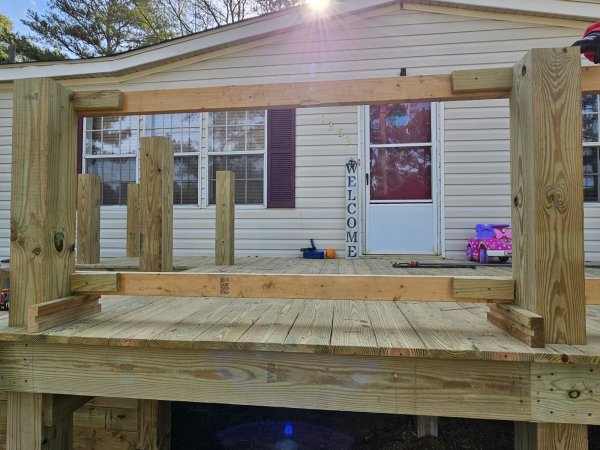

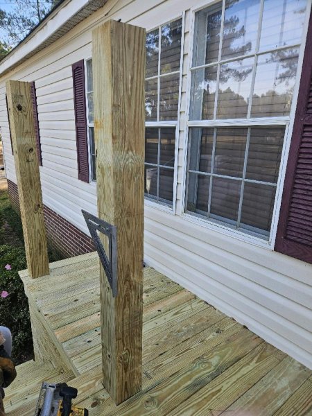

    We worked on the deck Monday morning after work, just Miz Carol and I. Had to do some innovative thinking...:sherlock::sherlock::sherlock:...

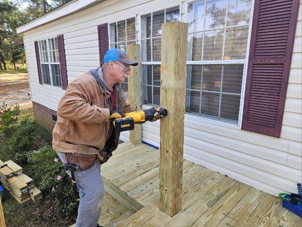

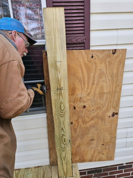

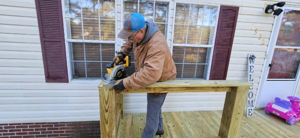

    First, we had to cut off the 6x6's at 36" height. Got them all marked, then screwed the 12" speed square to the post and used it for a guide on 2 sides 20847.jpeg

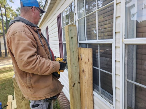

    The posts next to the house presented another challenge, cut them off without damaging siding or shutter...:sherlock::sherlock:
    Slide a piece of 7/16 plywood behind post, it was a tight fit at the shutter... 20857 (1).jpeg 20853.jpeg

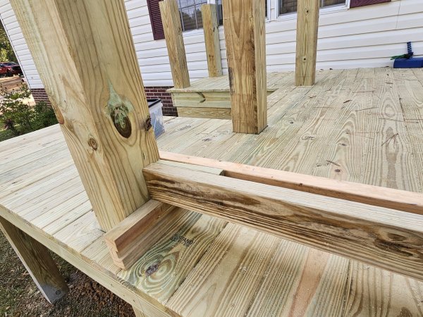

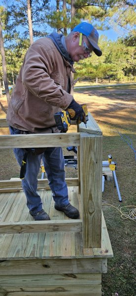

    After the posts were all cut, we made a jig to space and hold the 2x4's while toe screwing them to the 6x6's... 20231023_105649.jpg
    We got those completed before time to head home...
    Next is the cap board and pickets, maybe some underpinning.

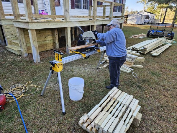

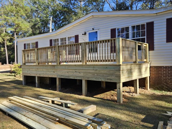

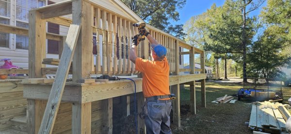

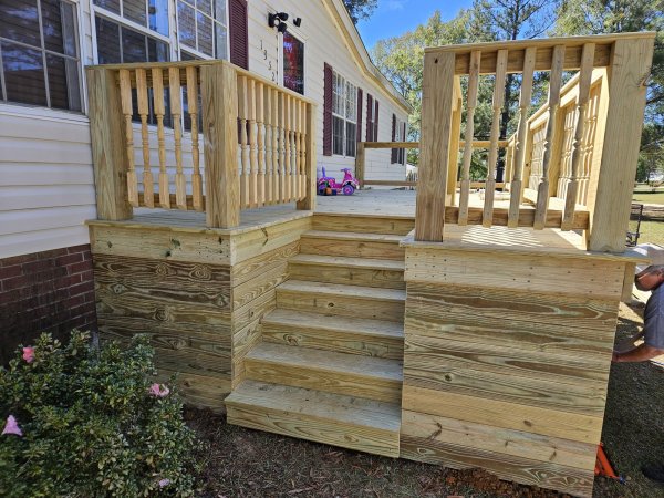

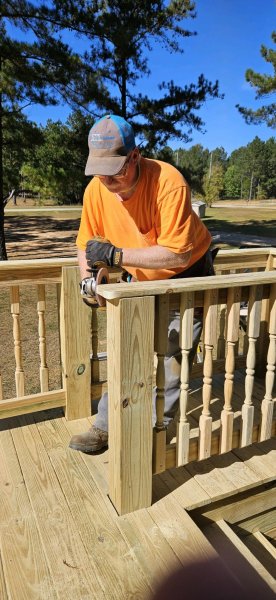

    We got a good bit done on the deck yesterday.
    Installed the cap boards...
    Trimming the miter for a tight fit

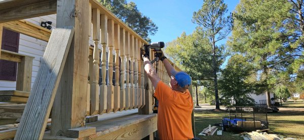

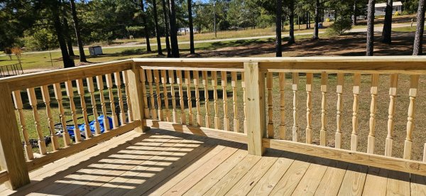

    We were 6 pickets short. Looked better with 3" spacing, I think 3 1/2" is what was figured.

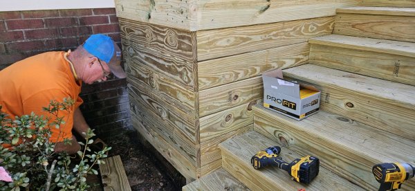

    We have about 6 more courses to run this morning and the pickets 20231024_162139.jpg
