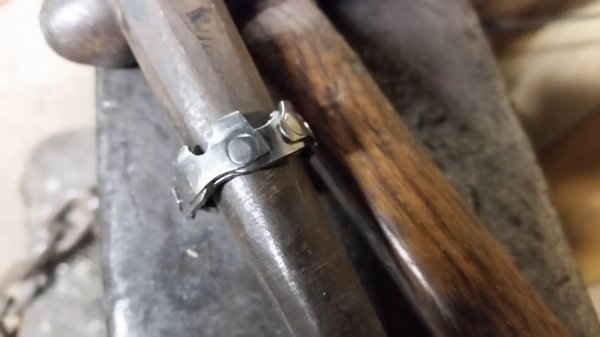

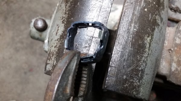

    I was in the shop tonight and I took a small length of Oregon chain and forged a few links into a ring. The next one I will heat in the coal forge and flatten it thinner to reduce its weight. I ground the bottom teeth off that ride in the bar.
    Rough shaping.
    I welded the chain ends together, heated it to bright red and formed it round on the anvil horn and used a punch to help shape it. The cutters were peened over and it went to the wire wheel for cleanup. I definitely needs some refining.

    I'll try another one and see how flat I can get it without losing the details of the links.
