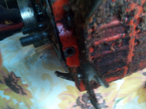

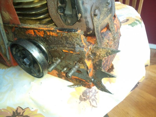

    So went to tension the new chain down today and realized the average scrench wont fit the tensioner. Where can I get one of these tools, a local auto parts store?
  18. bigbarf48
    bigbarf48
    Sep 25, 2014
    2,344
    4,702
    Stone Mountain, GA
    What kind of tensioner is it?
  19. Upstatewoodcutter
    Upstatewoodcutter
    Nov 11, 2014
    770
    1,670
    Upstate NY
    Upon further investigation I found the screw that runs the tensioner is missing, looks like I'll have to order one.:headbang: 2014-11-19 14.27.25.jpg 2014-11-19 14.27.03.jpg
  20. clemsonfor
    clemsonfor
    15,996
    37,478
    Greenwood county SC
    I was gonna saw...a screwdriver. But see you figured out the tensioner is gone.
    While you have that saw apart why dont you clean it a bit...blow it off with some compressed air.
