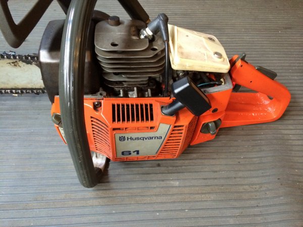

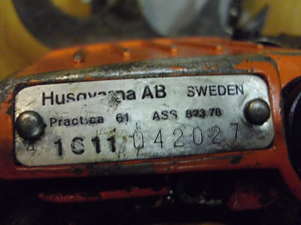

    Post a picture of your black tag. Saw might be a 61 or a 66! The top cover is not from a 61 (looks to be from a 66) but the starter definitely is from a 61. This kind of stuff happens all the time on older saws, no big deal really just that you need to know what it is before you order parts. The black tag will tell you what saw the factory produced. If it is really a 66 you did good.

    You got that right
    Not the stock cover on mine when I bought it

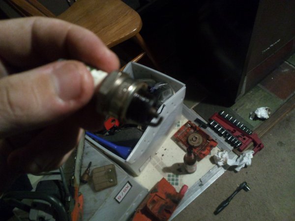

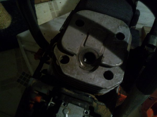

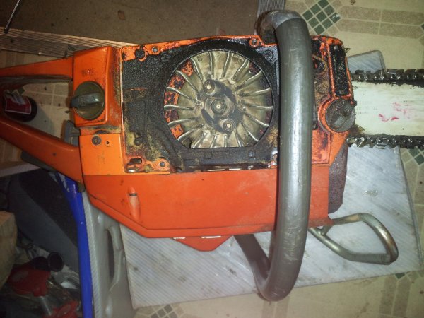

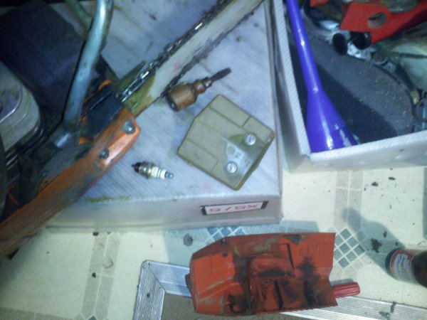

    Yeah it's a 61 has it etched on the tag. started getting her taken apart today to do some maintenance, not 100% sure but I think it needs a spark plug, other than a good cleaning. Cleaned the air filter as well out of habit and checked the carburetor, getting fuel but I don't have the tool to adjust it right now (needs a thin screwdriver). What do you guys think?

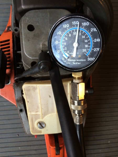

    I pulled my 61 out today, it had been a couple of years since I had run it. Compression checked out at 160+ PSI.
    Fueled it up and primed the carb. Pulled and pulled and got it to pop. Dribbled some more fuel and pulled and pulled. Switched arms and pulled some more. Eventually got it running and sounded good.

    Where can I get a compression tester for a saw? My dad has one for a car but I don't think it would work.
  12. Guido Salvage
    Guido Salvage
    1,735
    4,938
    The heart of the Bluegrass
    If you are in a rush, your nearby FLAPS will have one. Otherwise you can order on-line (Weedearerman.com, Amazon, etc.). Be sure to get one with a Schrader valve. I got a cheap one at Meijer for $30 and found a Snap-On at a local pawn shop for $35.

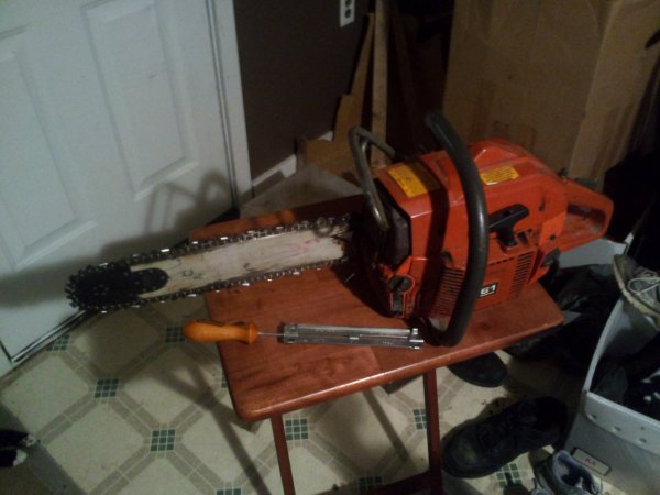

    After a tune up the saw runs great! The chain needs a sharpening desperately though.
    cnice_37 and HDRock like this.

    Thanks for the heads up Leo. I may order the part just to have it on hand so I don't have to redneck-engineer something. Here's the old girl on the table getting her sharpening. -Hopefully- will have a video of it cutting tomorrow.:D 2014-11-17 22.48.24.jpg
    clemsonfor and HDRock like this.
