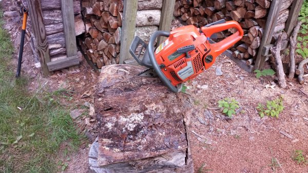

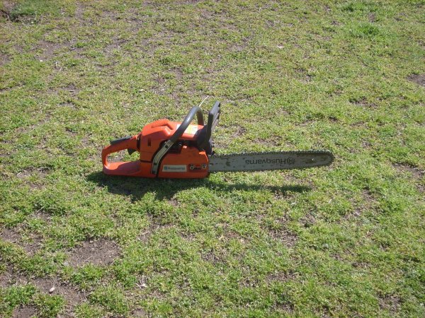

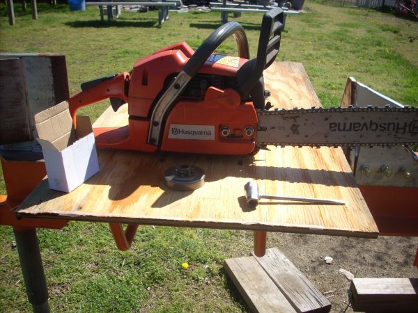

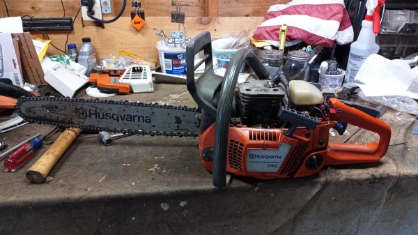

    First, I want to say a "Big Thank you" to all the help and suggestions, parts numbers and sorts with this saw! You'll all like knowing I installed the clutch today, but "prior" to that, I dumped the gas "again", checked fuel throught the carb, fresh batch of gas and perfect 50:1 Lucas oil ratio, a pinch/splash of sea foam and a splash of Marvel mystery oil. This time it started on the second pull, ran slightly sluggish for about 10 seconds then it was a "MONSTER"! It is idling fine and I just spent a good 10+ minutes running it up and down in different speeds, setting it down to idle, "idles perfectly now". I'm assuming this just needed the love!!! It is a real smooth saw. The Chain is smooth through the bar, oiling is good and I can't say anything bad! I don't know how to video but if I did, I do one! Thanks again everyone!!! Some pics below.

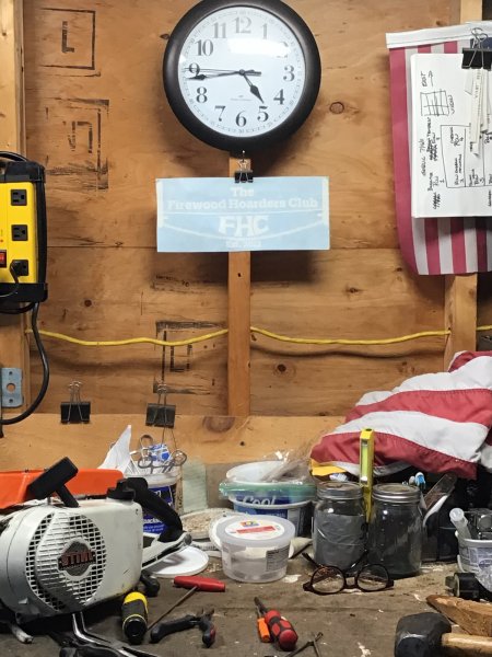

    The saw whisperer then declared it as a "viable saw ". I was then granted a peek up over the garage, at his saw horde. He's posted pic of it before.
    I left him with a very valuable piece of FHC swag - a large FHC sticker. He was cogitating on the right to place for it.
    Many thanks to M2theB !!
    A few shots around his yard

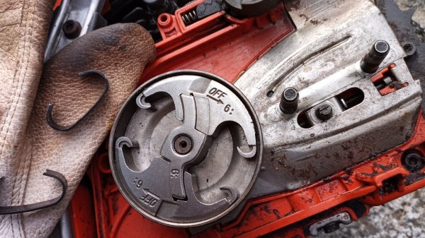

    I left the clutch and housing that was replaced.
    A few weeks ago, I had ignorantly pulled the clips on tbe clutch. :doh:
    Of course I have pics of that cluster
    M2theB never dealt with piecing together a clutch. He has the parts to do so now.

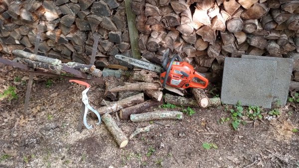

    I took the 350 out this morning, just to fire it up.
    It started after about 6 pulls. Revved it up a few times. Each time it slowed to idle, and kept idling.
    I'll put a load on it tomorrow morning. I have a few long branches, a couple inches in diameter that I'll strap together and cut through them all. Then, I have a chunk of oak to noodle.
  13. MikeInMa
    15,961
    115,830

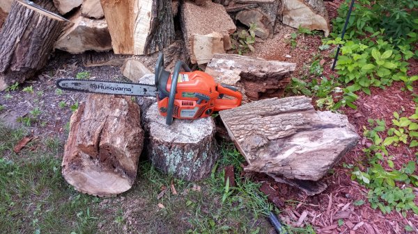

    It fired right up this morning, after a few pulls.
    I cut a few limbs

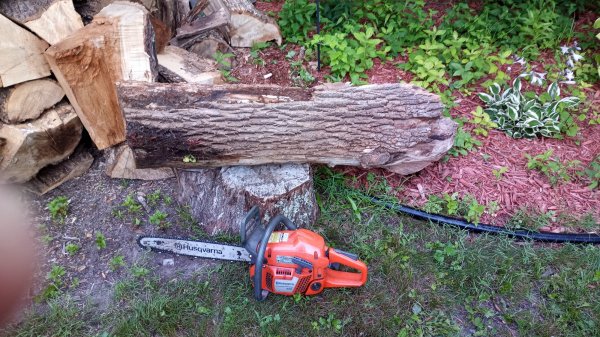

    I stopped saw and moved on to a log with some rot
    It cut well! It stayed idling while I adjusted after the 1st cut. I then stopped it.

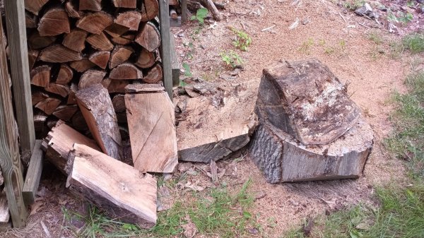

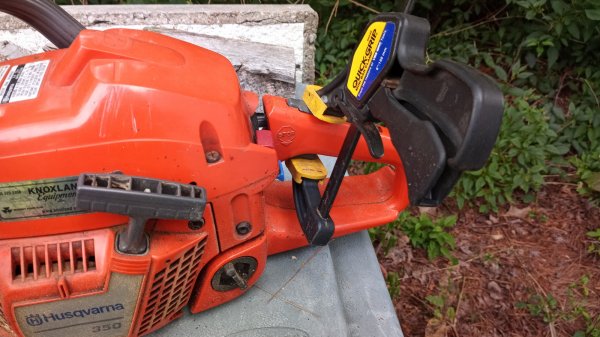

    I moved on to a chunk of gnarly oak needing to be noodled. It wouldn't start. I didn't have the hand/arm strength to start while holding the throttle. So-
    The clamp did the trick. It fired up after several pulls. On to the oak.
    After a couple different noodle cuts, I put it down idling, to move some chunks around. It idled for about 30seconds, then stopped. I couldn't get it to fire back up. I'll let it sit for a day or three and try again. It may need another visit to the whisperer AKA M2theB
    Noodled chunks
