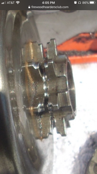

  5. WeldrDave
    10,203
    56,258
    Oil worm gear looked good! :yes:

  8. WeldrDave
    10,203
    56,258
    When I ordered that Clutch on Ebay, it said shipping from California, when I just looked at my statement the $$ went to Freakin China! Dam that PI$$ED me off... :headbang:

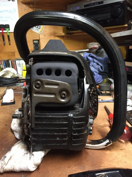

  15. Haftacut
    Haftacut
    Apr 1, 2020
    2,983
    17,435
    Rives Junction, MI
    Muffler mount screws were the issue for my 350 I had several years back. If you don’t stay on top of it. They’ll strip out the threads once hey loosen enough to vibrate. Ended up getting rid of the saw. Can’t beat a free saw though!
    WeldrDave and M2theB like this.
  16. The Wood Wolverine
    18,929
    122,088
    The fix is so easy, and cheap. Simply mod the 346 muffler bracket by cutting off one mount ear. This is the Jonsered version of a 350, dyed black.

  17. Haftacut
    Haftacut
    Apr 1, 2020
    2,983
    17,435
    Rives Junction, MI
    Looks great and like it solves the problem. Makes you wonder why the engineers at husqvarna couldnt think of it:rofl: :lol::rofl: :lol::rofl: :lol::rofl: :lol:
