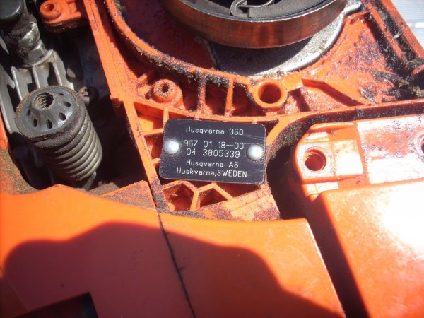

    The moment has came! Ok gents here's the tag! Am I to guess 2004 or 2000?

    2004 Id say
    I think the 38th week
    5339th made that year.
    I think that's how that's read

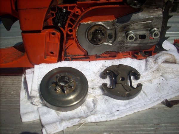

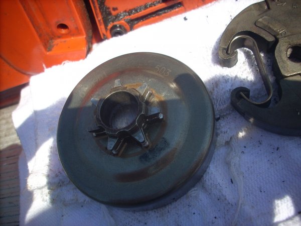

    Well, I'm no husky mechanic and Thank you all for the help! It came apart fairly easy. It would be in my best interest to get everything including the bearing. Am I correct here?

    Yes, get a new drum AND bearing, they’re often sold together. Never seen a spur sprocket worn that bad

    Just as well take a closer look at the worm gear for the oil pump while you’re right there also
