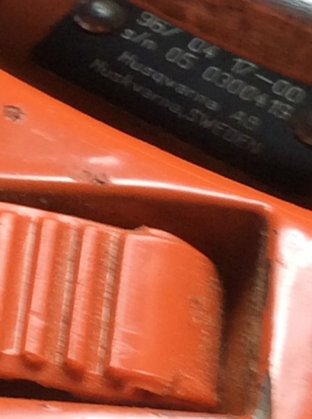

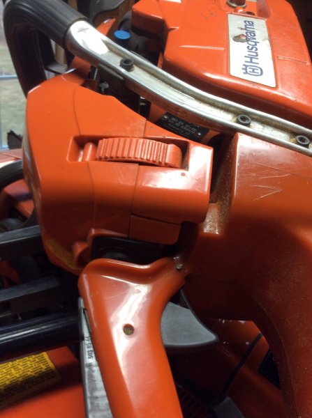

    The Wood Wolverine What on the sticker tells you a NE?
    Edit, got it. 52cc vs 49cc
    WeldrDave , the tag should a little lower,

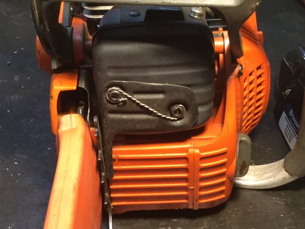

    14,244
    Muffler bolts! Classic
    The 350 is a good saw if you address the common flaws M2theB already pointed out.
    Sounds like you should do the carb to me. $10 and 20 minutes should be a runner.
    Also 8 pulls on cold start full choke sounds right. To restart hot, pull choke out then out back in to kick on high idle, then yank. The hot restart was less than obvious to me.

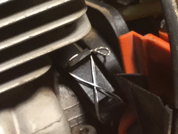

    Great saw ! There are a couple of things that you can do to help it as was mentioned above .
    Add a 346xp muffler bracket , and either replace the intake with one that uses a metal clamp to secure it , or this ... 6D079FAE-29D2-4FAC-8068-DD23C0970C46.jpeg 76D408A7-A388-4382-A8EB-E8F4665E1ABA.jpeg
    This is the 346 bracket .

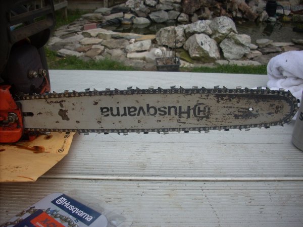

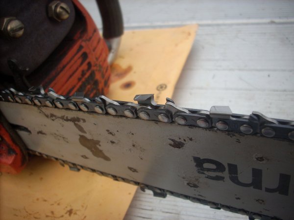

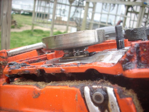

    Ok gang, got back from Lowes, got a new blade but I need to ask because I know little of the Husky, does this clutch look shot or am I dreaming? I've never seen a clutch with "tracks" through the clutch. I had to file and flip the bar, it had a terrible ridge. I'm assuming he never did it. the old blade went in the trash it was so stretched. After I put the new blade on it felt like it was "binding" real bad so I'm refering back to sentence 1. It was also a "B!tch" to adjust correctly and felt like it was still binding. Thoughts Please... :whistle:
  13. The Wood Wolverine
    19,022
    123,001
    Sorry brother, that clutch drum is toast. Ya need a new one.
  14. WeldrDave
    10,207
    56,309
    I Kinda thought so!!! :whistle: But as I said, not a Husky guy but had to ask.:confused:

    I take the plug out and pull the cord to see the piston coming up and when its where you'd guess past the ports, stuff a string (i use old boot lace) down the hole. That will act as a piston stop when you try to remove the clutch itself. small chisel or screw driver and a few whacks with a hammer.
    Should be an indent to put the tip of either on it, where it says off.

    Not wishing bad on you, but thanks for that pic. I look at those drives and wonder when bad is really bad. That pic does it for me!
    That’s an easy fix.
    I’d say though the saw has miles on it.
    I’d like to see the piston through the exhaust if you don’t have a pressure vac tester.
