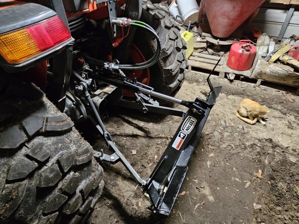

    Has anyone looked at Fit rite hydraulics stuff? I'm looking for a full top and tilt system.
  2. T.Jeff Veal
    29,905
    192,244
    Friend gave us one, but don't think it will work with the different equipment we have. The QA mounting plate came in, it will be welded to counterweight

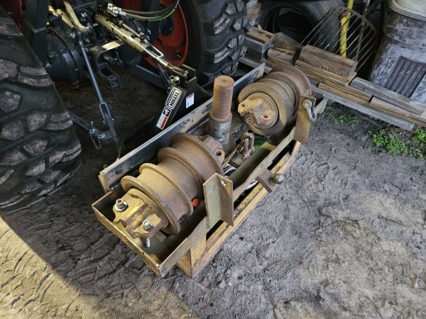

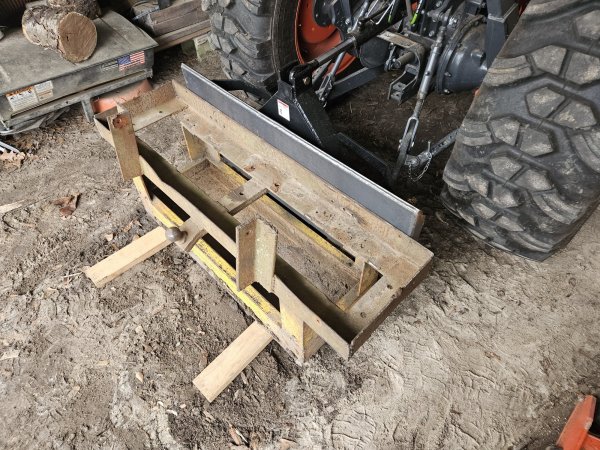

  3. T.Jeff Veal
    29,905
    192,244
    We got the counterweight box frame stripped down...big weights off, and 3pt frame removed. About got it centered where it needs to be. Hope to get it welded Tuesday.
    It's sitting on some 2x4's, not some fork extensions...:wacky: 20260308_130710.jpg

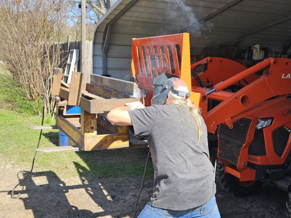

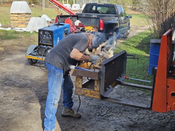

    Our neighbor Mike's brother, Steve, came over Tuesday and got the attachment plate welded on... 20260310_103249.jpg

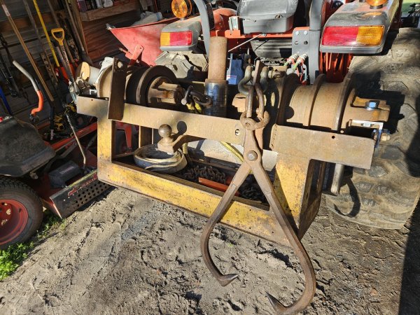

    We used it Wednesday on a job. The big weights were still moving around with the threaded rods holding them.
    So with rain Thursday morning, I did some :sherlock::sherlock:and :binoculars::binoculars:on it. Found some heavy 3x3 angle iron we had, cut some pieces 3" long, drilled some ¾" holes in top plate and bolted it to the weight 20260312_180106.jpg
    Clamped that to the frame and drilled ⅝ holes in the sides. Weights are pretty tight on frame now..:thumbs::thumbs:
    On the back uprights, drilled the holes bigger to hold a clevis on one side. It can hold the big log tongs... 20260312_180115.jpg
    We need a slip hook to bolt on other upright to hold smaller tongs.

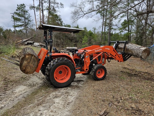

    Technically you can now run a dual grapple setup...one on the front and another on the back. Might be handy for a long haul brush removal or something.
  12. T.Jeff Veal
    29,905
    192,244
    Tried it with grapple and forks. Works great. We would need a 2nd set of rear remotes to run grapple. 20260228_140119.jpg
