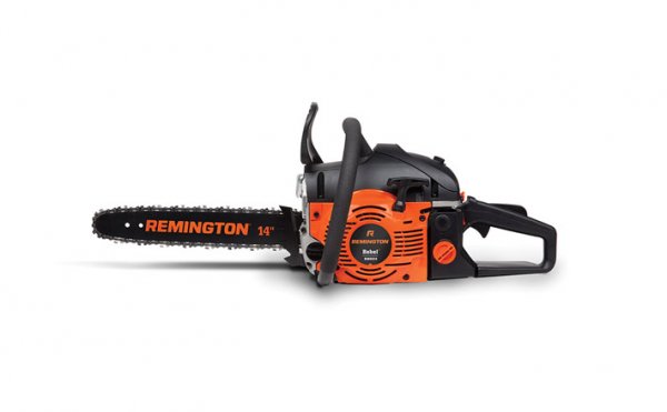

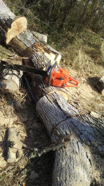

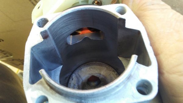

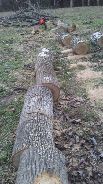

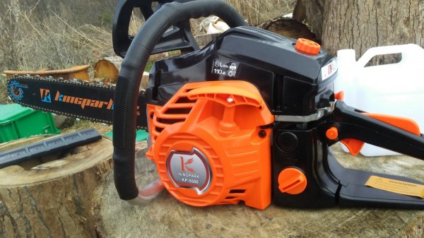

    I bought one of the 58cc versions of this saw this spring it is well built overall.
    but the on/off and choke lever are flimsy but still working mine had the stupid start assist.
    I ran a couple of gallons through it dropping and blocking dead ash.
    I muff modded it and mildly ported it.
    It runs very well about 257 husky power but lighter.
    My friend tried it and wouldn't stop pestering me until i sold it to him he uses it all the time for firewood.
    It was 79.04 shipped this spring over 100.00 now.
    But still good saw's for the money this same chassis is in the new craftsman and remington and blue max and other saw's with different plastic's.
    Not pro level but the everyday firewooders i know like theirs. 20170131_152738.jpg 1486247759570-1535939894.jpg 20170202_165649.jpg 20170202_165744.jpg 20170208_163130.jpg product-chain-saw-RM4214-detail-1.jpg 20170129_141925.jpg

    I understand what the muff mod is; to reduce the exhaust restriction. However, what does ported mean?
    Czed likes this.
  10. clemsonfor
    clemsonfor
    15,996
    37,478
    Greenwood county SC
    In laymen terms it is removing metal at some place In the cylinder, usually transfer ports and or intake and exhaust ports or some combination of all the above to make it flow more fuel and exhaust. Sometimes reducing piston to cylinder clearance by machine work to achieve higher comoression. Sometimes original port designs maybe filled and reshaped to a builders preferred proven design. This with carb work and coil or timing work the saw will turn higher RPM'S and produce drastically more power.
    But I am sure I left a few things out as I am no expert on this stuff.

    I just simply made the exhaust port wider.
    And removed the baffle it was very restricting.
    It allowed it to breath better lol
    After retuning it felt like a different saw with more torque.

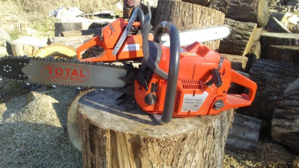

    I had a lot of 371/372 part's and over 20 husky bars.
    From all the years I've been fixing saw's or picking up basket cases.
    I couldn't find a good builder 371/372 this spring so i bought 2 of the china 365s and went through them they were cheaper than trashed saw's around here.
    Ported 372 cylinders 268 piston in 1 big bore in the other bailey's oem wraps 20170313_152514.jpg .
    "Poleman" rich built me a twin jet zama for the saw that has the 1 on it.
    I haven't used the second one yet still on the first one lol
    I like these saw's around 300.00 in each one instead of oem prices.
    I'm just a firewooder now they are perfect for what i do. 20170217_151517.jpg 20170606_203227.jpg

    If you look at it close clem , it doesn't say husqvarna , it says Hnsavrqua

    I just saw the close up of the clutch cover!! "Hnsavrqua" !!! Hahaha
