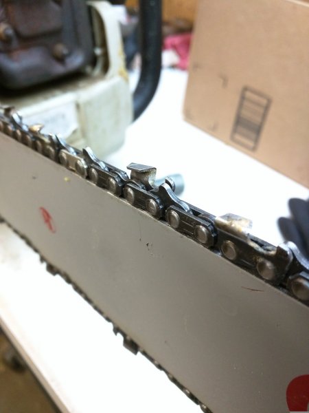

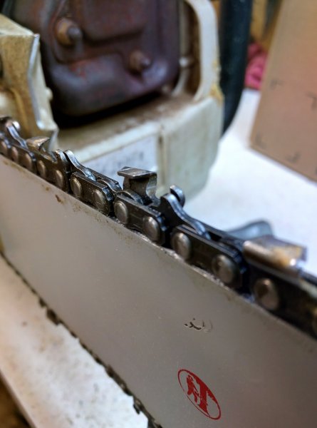

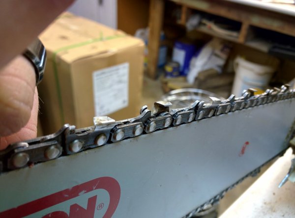

    In your top 2 pics, the cutters are dull. Judging from the side view in the 3rd pic, either you've hit some metal with that chain, or its been in need of sharpening for a long time.
    You'll want to take some more off; the whole folded over part needs to go. Get yourself a new chain to compare with. One of the main things you need to learn is what a sharp cutter looks like. The cutting edge shouldn't reflect any light.

    That specific chain did meet a chain link fence last time i used it, well before i had sharpened it and used it the other day.
    I'll try er again tomorrow and post some pictures.

    Your chain is semi chisel so you won't have the point in the corner that is in Shawn's pic. You'll have to take it back a bit to get pass the damage from the fence. So you'll have to reset the depth gauges to get it to feed right.

    So i am essentially just filing down the top edge of the depth gauges?

    Yes. Its best to use a gauge like was posted just a bit earlier. You'll eventually get into the bumper on the chain in your pic as well.

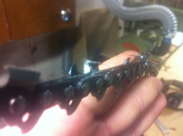

    These are my growing pains when I first bought mine. I was cutting in a very rocky area, rocks and boulders everywhere. So the first few times I came upon a damaged cutter, I just kept the pawl the same and tried to use the same technique. Mistake.
    They are pretty old pics and I've learned my lesson. Small "bites" and remove all burrs with a round hand file. ;)

    Yeah I ease the pawl into the chain so its not taking out a big bite.
