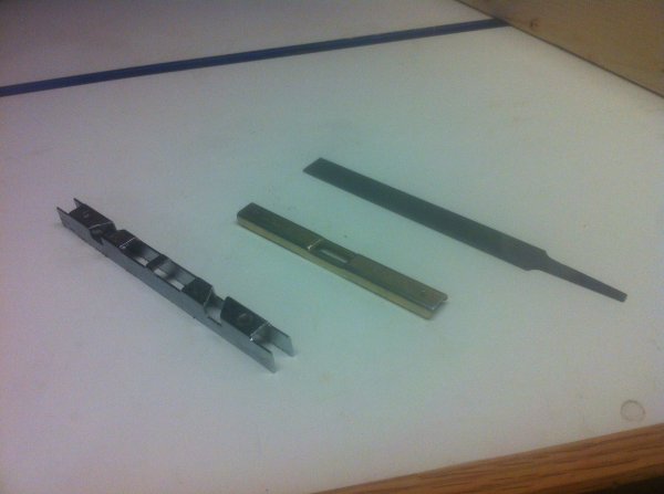

    Here's what you'll need:
    The special tools are really just measuring devices, a straight edge and a set of feeler gauges could also be used but that process is very tedious. I got the middle one and the flat file in an Oregon sharpening kit. The one on the left I ordered from Treestuff, and it has 3 different raker heights and you can use it as a rail cleaning tool.
    You place the special tool over the raker, and file it down with the flat file until you can't remove any more material.
    Carefully adjusting your depth gauges will fix both conditions you described, though the diagonal cutting is from your left and right cutters being different lengths. If you don't have a caliper, a crescent wrench can get you close enough.

    Shawn,
    You ever try to use that guide from tree stuff? I got that same one a few weeks ago, and tried it. Unless I'm doing something wrong with it, it don't work as a depth gauge for rakers. The reason is, it is too long, and stirs on top of too many cutters, so you can't get it to sit down between cutters with the desired height gage below/next to a taker. I tried everything with it, on 3 different chains including a full skip chain still wasn't enough space betwween them for that thing to lay right. I have regular Gage's like the other pictured that work just fine. .???? Anyone else notice this with the trees tuff multi chain gauge?
