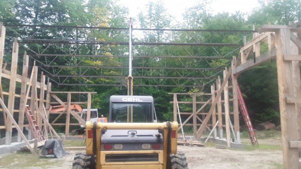

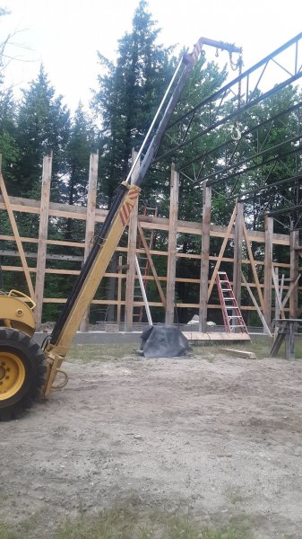

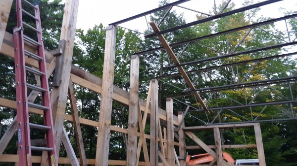

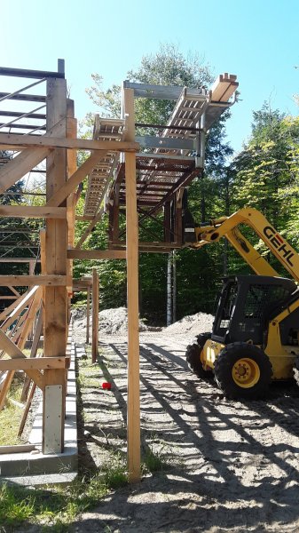

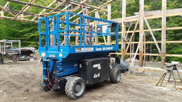

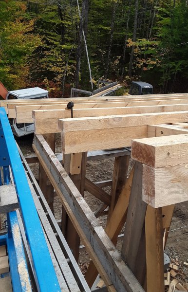

    It took some patience, but I managed to operate the SS and half jazz work a tag line (just on one side) but I'm developing a method and as usual, just as you get good or efficient, that task ends.

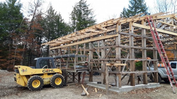

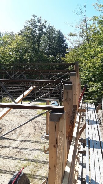

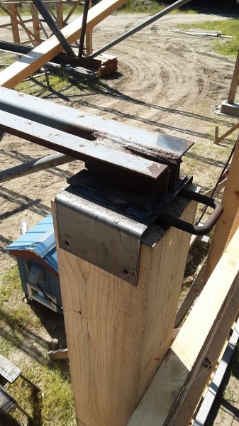

    I've got all the trusses up and about half of them have the caps welded to them and lagged on the posts. This odd roof is going smoothly so far, it's definitely different and I've been worrying about it all along. I guess it's better to worry (unnecessary) about something and that hopefully brings up any "issues" before it's a problem. My last concerns are the overhangs. I like a generous length all around. I've got a plan but am better visualizing it with a few of the basics in place. 3' is a minimum target for the lower roof eaves, it would be nice to have most of the snow that will be coming off the roof that far away from the rolling doors that are in the plans. 20210908_190702.jpg
    I'm happy to report that my bigger portable generator is powering up my small inverter
    welder just fine, now my stick welding skills are a little rusty but it doesn't need to be real pretty. My big Mig welder sure has spoiled me.
    Got a couple of days of wet coming, but hopefully the roof trusses will be adjusted and secured by Friday.

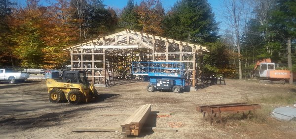

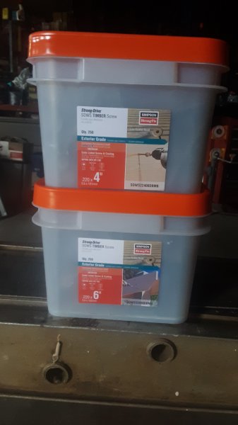

    The roof "system" is stiffening up nicely just by bracing the bottom chord of the bar joists. Normally it would be a steel bar or angle welded in, I'm just doing it with wood.
    I'm not sure how many times these joists were moved around, but half of them are "tweaked" in one way or another. In order to make them straight and vertical I'm running a string line across the bottom chord and working to that (on each one). This was after a few other approaches just didn't work out.

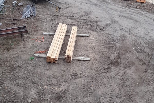

    The brown truck dropped off some more stuff today. The more I use screws (for the weird chit) the more I like them.

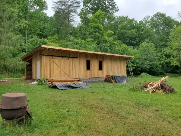

    Here is my latest
    If you need a stopover or any help when in PA let me know.

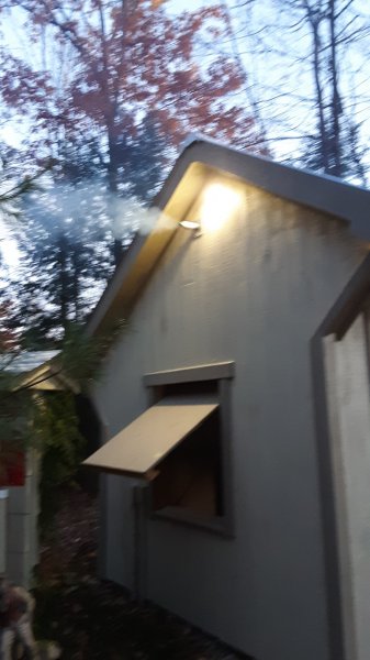

    It's some weird sickness, but I'm never disappointed when the power goes out (with the right backup).:whistle:
    Only a few hours.

    The building will house a wood boiler and water storage, small "shop" and on the end is room for tractor and mower.
    Butt you siding tight together and screw the battens in the middle. No gaps, let it shrink.
