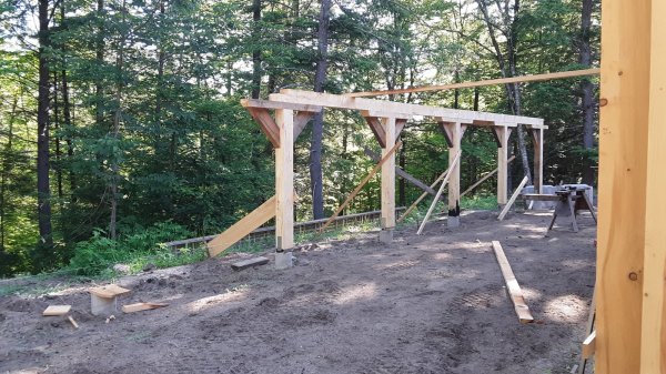

    Almost ready for rafters.

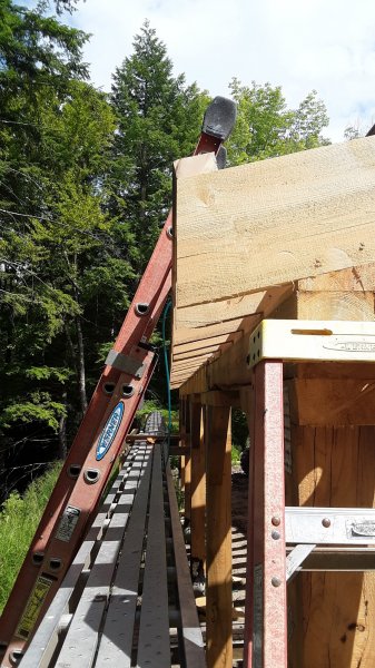

    Uh oh
    I guess if you can blame a gun...
    I can blame my pencil :whistle:
    My birds mouth (proposed) cut didn't work out. Stupid pencil.
    Glad that I hefted that heavy sucker up there to check it before I cut all 31 of them.
    I need to investigate a little more but I think I'll be cutting a 2 1/2 × 8 to lay on top. My other choice is just blocking them up with a 12" 2x6 vertically avoiding a bunch of cutting for the birdsmouth.

    My "correction"

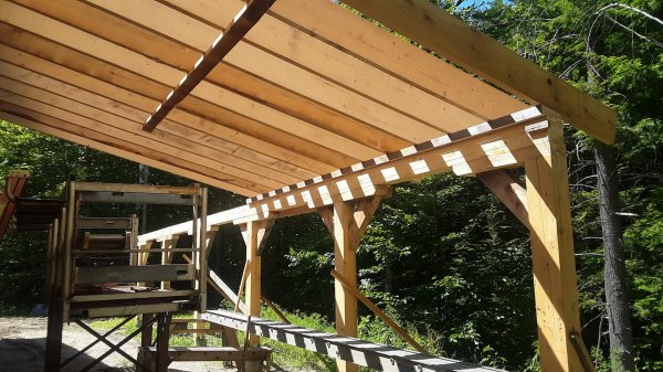

    I sawed some store sized 2x4's for the purlins. Feels like a 1x3.
    :whistle:
    It's nice to be able to use a regular sized framing gun and nails.

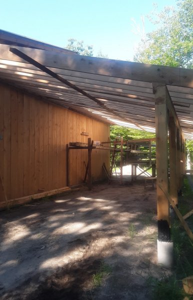

    It's a nice space and I'm glad that I'm sticking to my plans. I've been a little bored with this project for a while, now going on it's 2nd summer. Getting close to the finish line.

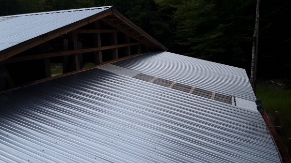

    Roof is on the lean to.:D

    Looks real nice !! I hav not been here in a while very busy , Are you going to fill in the peak side with wood or are you going to use clear panels to let in some more light ? JB

    I'll have to make this decision very soon, that's next.
    I was thinking about the clear or even metal because of the splash factor of rain bouncing off the metal roof, (excessively wetting the wood that never sees direct sunlight) but in my slowness of getting the roof on I haven't witnessed any of this areas (wood/framing) getting soaked or even wet. The gable overhang is about 20" and not far away vertically.
    Wood, inexpensive but a bit more labor on the roof.
    Clear polycarbonate sheets, I'll need to order this and they come in 8' - 10' and maybe 12' lengths and I'll need to figure out the best lengths to eliminate a lot of waist.
    Metal, again I need to put a cut to length order together and both of these materials are pretty high priced right now.
