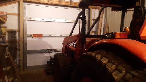

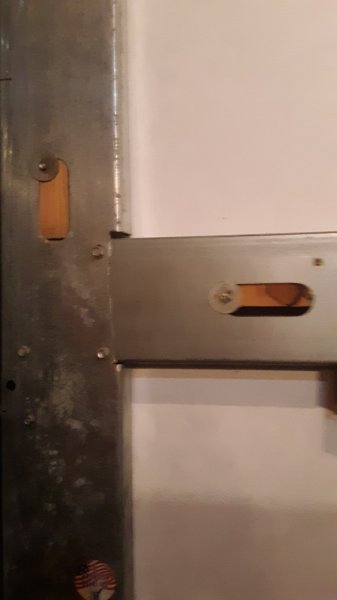

    A few years ago I built a 12' wide single rolling door and used structural steel studs, like you'd see on some commercial work. They're available in different guage thicknesses and for that size door I just didn't trust wood. It's a pretty big panel, 11x12. Rock solid. 20220605_210946.jpg
    I filled the "C" with wood so that I could use the normal "barn metal" screws to attach the metal siding.
    The white is the back side of the tyvek.
    Metal seems to be even more expensive than wood now and I didn't even price it out for the new doors. They were pretty heavy guage, iirc 16ga.

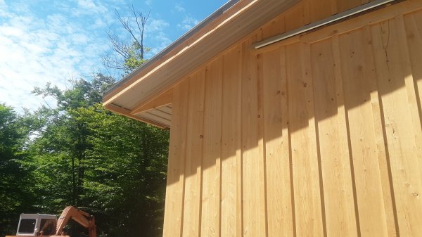

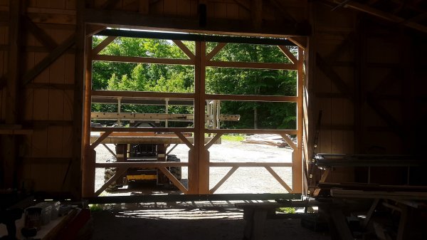

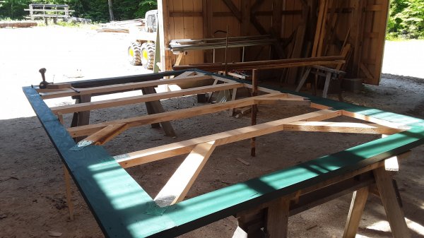

    Ok, now the front doors.
    Being 12'4" tall I decided to build them on sawhorses, the other 2 doors are just under 10' and weren't too bad to build in place.
    I got them built and anything that might see rain got painted.

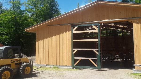

    The trouble was going to be finagling them in with the one side out beyond the overhang, you can see that there's little room to work with and I was just hopeful that it fit. Removing a section of track would involve the siding, battens, and the aluminum cover.
    Here's the door sitting on the dirt, looking like a royal pain to try this alone. Being a proper hard headed sumbich I said to myself wth, it'll work or it won't.
    Me and the SS got it much to my surprise. One more panel to go then I need to find a couple of 13' logs to cut the siding. Right now I think I'll just go with regular battens with maybe a few live edge ones sprinkled in.

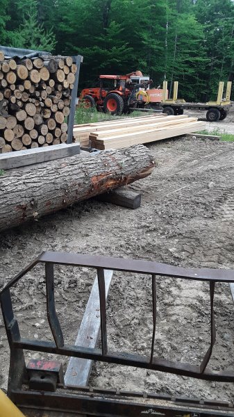

    Rafters for the lean to.^^
    ^^And some more logs to saw. I need about 16 @ 13' long for the front 2 doors below.
    2x10x16, ^^^ some of the rafters.
    My load today from at my home depot. :D

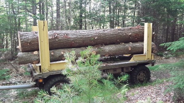

    Yesterday it was a tree!
    Who knows, it's possible that it may live on for another 50 years as a door.
    Not far from where this tree grew there's an area where I harvested some beech trees for firewood, that's been 3-4 years ago and the pine that's coming up in the newly sunny, open area is the way of the woods.:yes: This hemlock left a good 50' hole in the sky that will really "release" the much smaller neighboring trees.

    Are those 5/4 boards or a little thinner ?
    Eric VW and brenndatomu like this.
  19. fuelrod
    fuelrod
    Oct 4, 2014
    3,508
    20,534
    Western Maine
    1", that was the middle log out of 3 from that tree.:thumbs: there's 12 boards in that stack.
    86* here and my batteries are fading and the easy chair in the shop that's pretty cool was calling me. :handshake:
