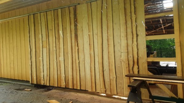

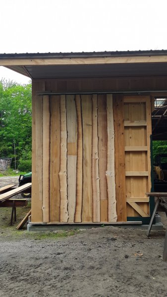

    Ok, am I coloring too far outside the lines :loco: :crazy: or do you think it works? 20220603_111346.jpg
    The "picture" in my mind was out of focus, but the more I put up, the more it comes together, for me....I think. :D

    Takes a bit to get used to the visual but I think it looks great.

    I like the aesthetics, maybe not so much if it is painted. I used to like board and batten, but when/if the battens start falling off - not so much.

    Those doors look awesome, they just need to fade from the sun for a while. You do amazing work, this is a great thread, thank you!

    No plans for painting and I screwed the battens on. I hopefully won't have any problems with them. :whistle:

    Any chance for a hard/driving rain to get between/behind them when they are vertical like that? Otherwise it looks good to me also!

    I think I know where you're going with this, I spaced the siding boards as wide apart as possible for each selected batten in an attempt to avoid forever wet wood to wood contact. The roof drip line is 40" out but it's possible that a wind driven rain could wet it. Time will tell I guess :whistle:.
    The 12'6" tall door on the gable end with only a 20" overhang will be the one that worries me.

    Right on. Worst case scenario is you'd get to mill some more boards:thumbs:.

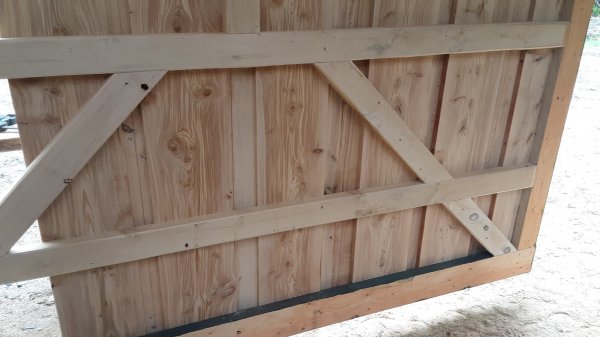

    My bigger question is how's the little bit of bark going to behave? I'm sure it will eventually fall off.

    As much air is going to be moving thru and around those doors… I would just keep a broom handy as the bark gives up it’s grip.

    The only bark I've seen stay on was a live edge counter top that was multi-coat epoxy covered.
    It was glossy and didn't really look all that natural - and it was indoors out of the weather.
    I suppose one could stain or paint the live edge after the bark fell off. Never seen it done though.
    I kinda like the natural grey patina.
