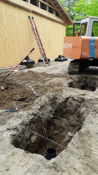

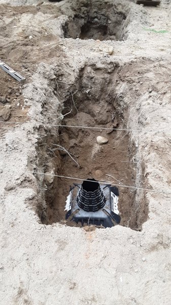

    Working on the lean to off of the back, footers with sonotubes up to grade. 20220519_090524.jpg

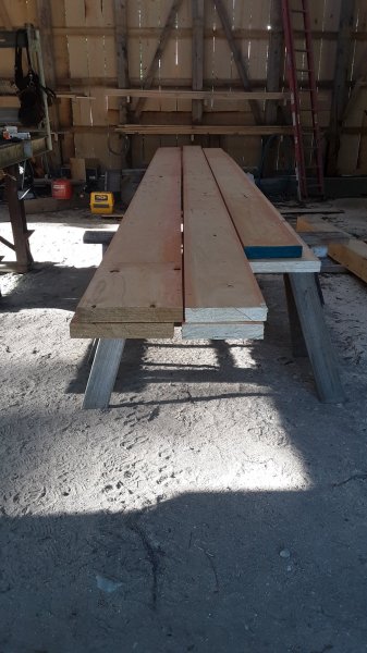

    I also got my first "store bought"
    lumber for this building.
    Those are LVL's that I'll rip in half to make the rolling door frames. They are very stable and warped or twisted lumber is not helpful with the fairly close tolerances that you have with this type of door. (passing over the jamb and adjoining wall to open)

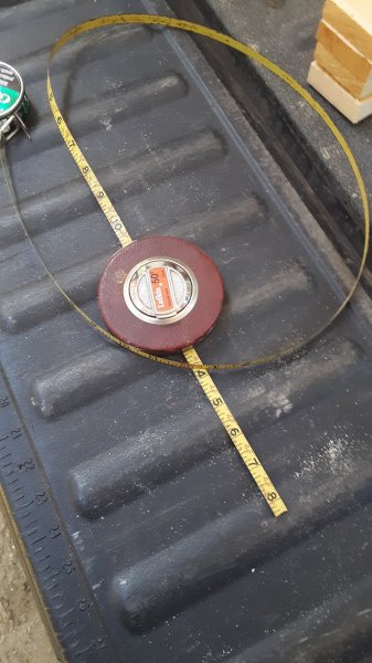

    Dang it, lost a friend of about 25 years just now.
    Wouldn't you know that a replacement blade is the same price as a whole new tape. :loco: :crazy:

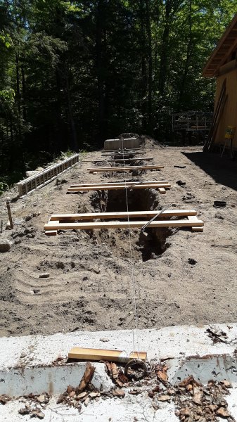

    All the base forms are set, the sonotubes cut to elevation, rebar cut and bent. I'll call the concrete plant Tuesday to see about a delivery.
    Got tired of readjusting and checking the string line on stakes in my dry and rocky ground.
    A little overkill, but you ain't bumping these babies out of place.:whistle:

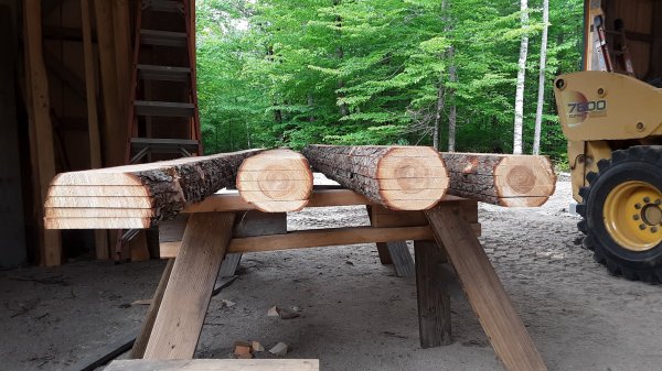

    I decided to get a little creative with the doors. These are going to be live edge battens, I'll do the side that you need to walk around the building to see first :whistle:. I'm going for a little "ode to the tree" look and I have a picture of what I'm looking for in mind, just not sure if I can pull it off.
