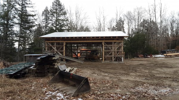

  15. fuelrod
    fuelrod
    Oct 4, 2014
    3,508
    20,534
    Western Maine
    My low pitch is easy, but on most of my projects the pitch is 6/12 or steeper. Don't think that I haven't pondered what would be worse, leaving little chunks of my arse on every little screw head that I was sliding across, or the eventual landing. :rofl: :lol:
    I should have the ridge cap done in short order tomorrow if there's no frost or something else to distract me.
    Then I've got to drop some big hemlock. Anytime now the woods could become difficult with snow.

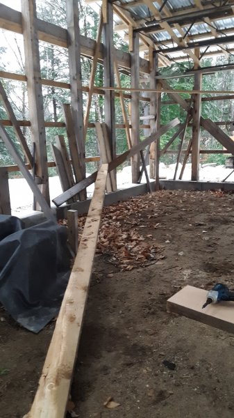

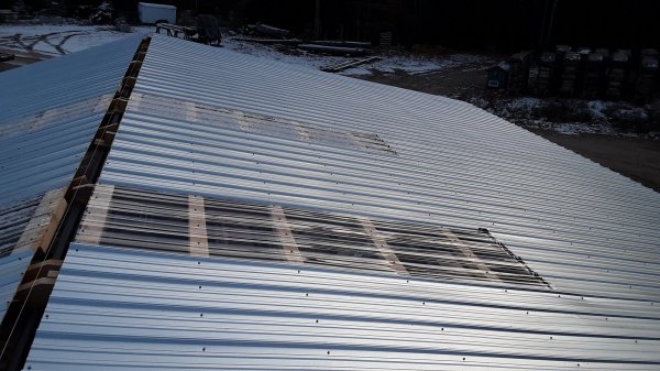

  18. fuelrod
    fuelrod
    Oct 4, 2014
    3,508
    20,534
    Western Maine
    20211201_141006.jpg Yea!
    Got weather coming the next few days.
    Hinerman, Jack Straw, Stinny and 12 others like this.

    Western Maine
    The roof is working :D
    I'm now blowing the leaves out and cleaning up the inside so that I can have a little more room inside to work.
