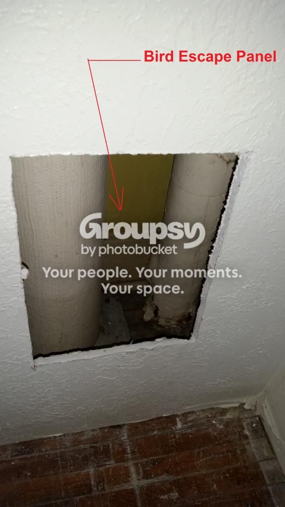

    First things first. I cut open the back wall of the closet to gain access to the chase.
    Sure enough there was a very tired sparrow on the floor of the chase. He hopped around for a while until I got him in my big paws. Now you would imagine this where the story would end. The big hero of the hour takes the helpless little bird outside and let him free. But as you can guess, that's not what happens.

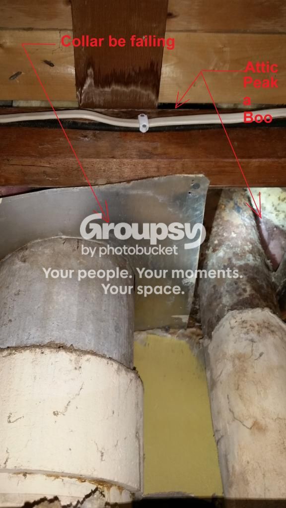

    Now as calm sets in I poke my head into the chase to try to figure out how said bird managed to get into the house.
    What I was greeted with was that the ceiling and metal collar around the vent and furnace pipes had failed. Before the last set of shingles were put on, apparently there was a leak around the pipes where they penetrated the roof. The old ceiling tile around the vent pipe, had sub comb and collapsed leaving a hole that was covered now with insulation batts.
    I'm still not sure how the sparrow was able to push his way through the insulation but there must have a been a gap large enough to do so.

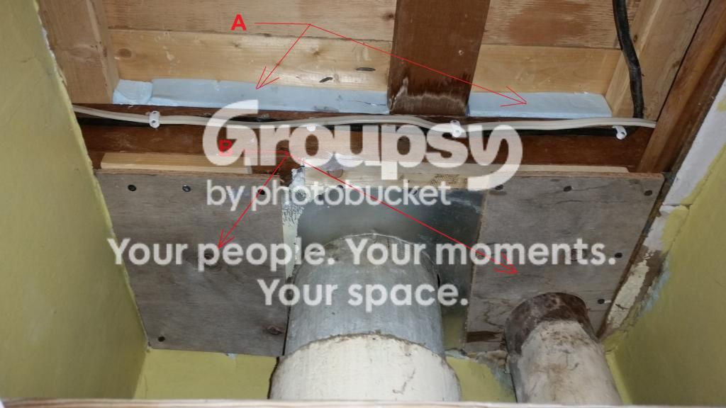

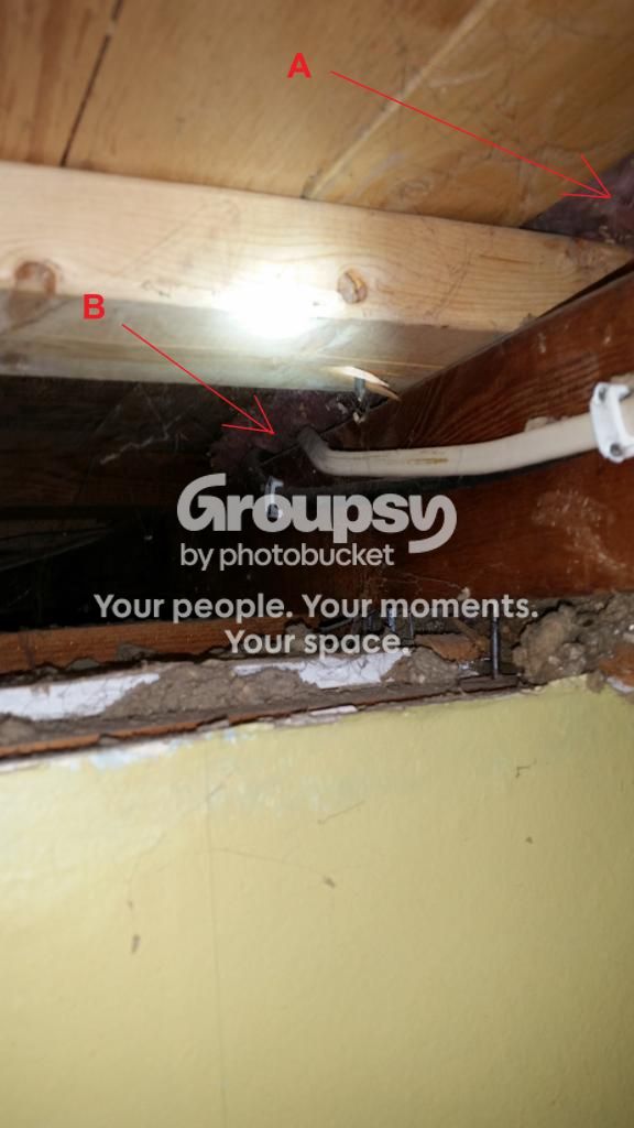

    After cutting a couple more holes to get a better look at the awkward space I also could see there were gaps between the framing that my FIL had built that led right into the attic also.
    Some of the gaps were completely open (A), while others had numerous wire runs for the various outlets in that part of the house (B).
    I found out that the holes I had cut couldn't be enlarged enough for me to work on it, so I cut yet another hole in the ceiling of the closet so I could get my big head up into the area.

    The ceiling repaired (B) and the easy gaps filled with blueboard (A) I headed up into the attic, spray foam in hand for the areas I could not properly fill.
    As most of us know working in a cramped attic, stepping on the trusses, hunched over below the nail laden roof sheathing, all the while breathing in fiberglass strands is very enjoyable...but for some reason, today I wasn't feeling it. Odd.
    Anyway, after pulling the batts back I got the gaps filled completely, the area around the furnace pipe insulated with fireblock spray insulation, put the batts back in place and got my dusty butt out of there.
