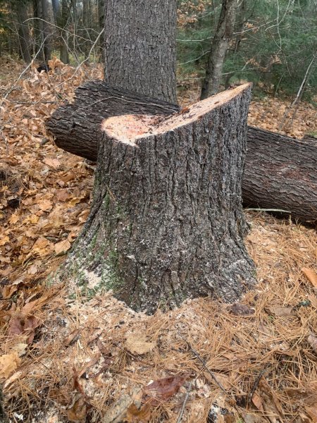

    You guys are right it was the angle back cut. I took tape measure out. It was 14 inches across and 37 feet tall.

    Yeah not much of any hinge/holding wood that I can see. The face was about the correct depth, maybe a hair deep if it was leaning back, but definitely OK in my book.
    Good on you to go back and have a look and posting up what you found. That's not easy on forums as some can be overly judgmental. On the other end it seems like most young people can't take constructive criticism, you sir don't have that problem and have earned my respect.

    Andyshine77 and others.. I just wanted to make sure I knew what went wrong and treated as a learning experience and I appreciate the more experience guys tell me what went wrong.

    Andyshine77 was right on the money with his assessment.
    FWIW, I do a critique of every single tree I fell to see what was correct and what isn't. Often people get careless putting the face cut in and overcut or undercut. To be more accurate I do the downward cut first, then site down the kerf to see exactly where the bar is in order to make exactly matching cuts.
    I try and think of balancing a glass of water on the bar to make sure it is level when making the horizontal cut of the face and back cut. Try it, you might be amazed how far you are off.

    Yep, angled back cut and hinge chewed out + crown weight = spin.

    Hey always willing to learn..We normally talk about trees before we drop them. This one is best described as a wooden telephone pole. There was not a branch on it about that height and diameter.
