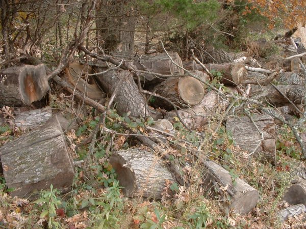

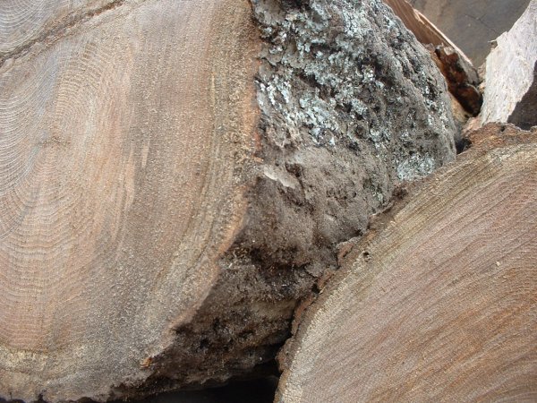

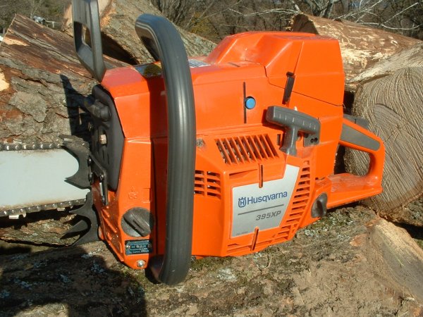

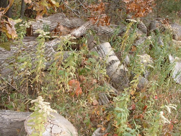

    People's opinion of what constitutes a "sharp" chain varies a lot. To some, as long as it is not smoking and the bar isn't blue it's "great".
    I find it's best to sharpen with a few swipes before it gets dull.
    This is what I cut, the only thing that has a chance of lasting a tank is .404 semi chisel on a hard nosed bar with the 395XP. 10-31-19 12.JPG 10-31-19 16.JPG 10-31-19 10.JPG 10-31-19 9.JPG 10-31-19 13.JPG 10-31-19 11.JPG

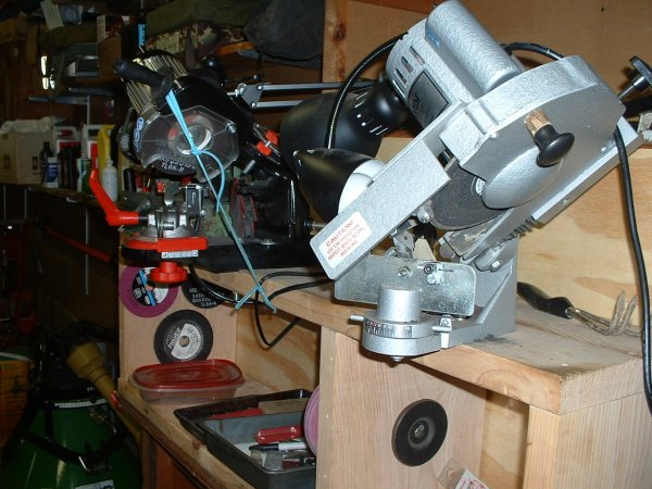

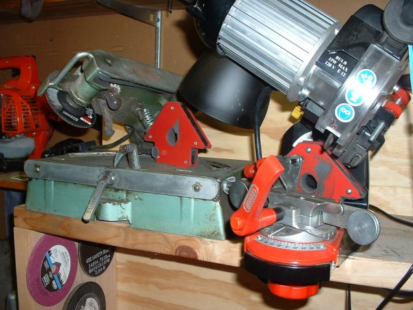

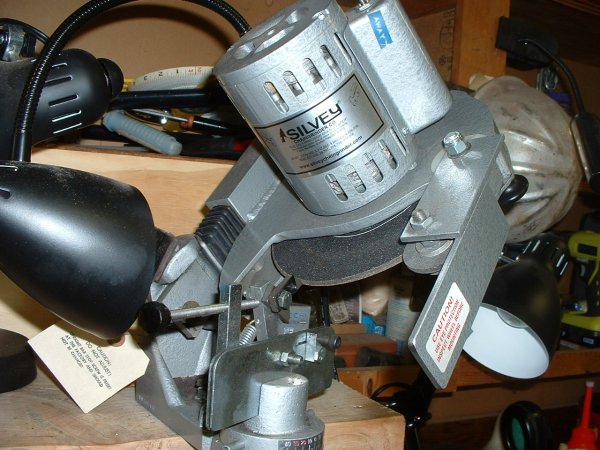

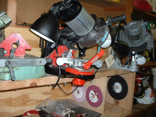

    My neighbor says he could tell if it was me running a saw or one of the other neighbors from the sound. The neighbors had a very high pitched drone that went on and on and on. My saws had a much lower tone and never seemed to be revving. I keep chains pretty sharp and stop if they are not.
    Here is some grinder porn: (The Nielsen is switched out right now and a Tecomec clone with an experimental Silvey style vice is in it's place right now, for rakers)
