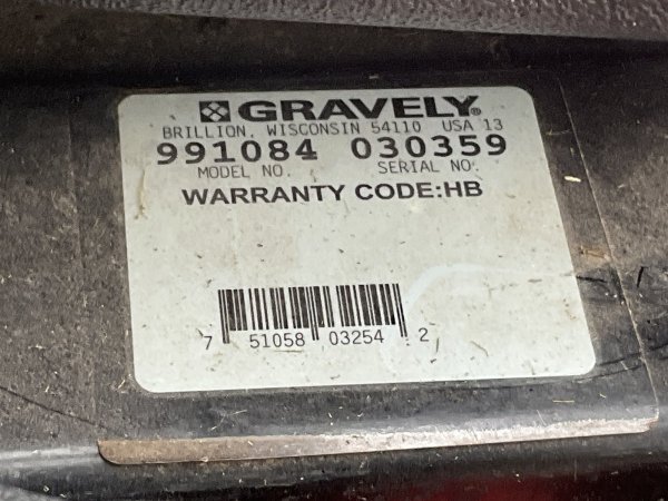

    She thought they had more paperwork, some maintenance history & such. I still have some things to go through, didn’t find anything yet. Yes, the 2700 hours seems high, maybe the key was on, never thought of that as contributing, maybe.
    Here’s the model & serial number. It does drive fine & straight, I’ll get to the hydro fluid soon. Even if I don’t do the spindles, I at least want to check them better. This mower like many have the sealed spindles, no grease zerks. That’s an issue with varying opinions.

    Yeah that's a 2013 gravely ztHD 60" that's definitely a Kawasaki, and probably a 24 HP FR730V.

    Thanks, so 2013 model. I still have some evaluation to do. Somewhat related is a relative that mentioned offering up a new zero turn Cub Cadet that he may not want to keep. He said it was likely more mower than he needs. He did get it for a good price, and would still cost me over $2500.

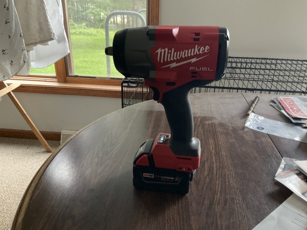

    The blades were so-so, not to old but buggered up. There was plenty of good blade left, sharpened all 3. One spindle was bad, worn, out of round, making noise. I found the replacement locally, put on. I need the pulley above, ordered from fleabay. I checked the hydro fluid some, newer filters in place, 15w-50 syn motor oil. I’ll wait on the change a bit.
    The big thing today was a new Milwaukee 1/2” impact driver from H.D. I’m kinda older school with tools, usually a breaker bar with a cheater pipe can get the job done. These blade bolts were giving me serious fits. I only got one off with my conventional methods, breaker with a 4 foot pipe, serious leverage. I gotta say, the impact was more than night & day difference. I used my older Cub Cadet today to mow, once started, worked fine.

    A 1/2 drive impact is one of the tools that I thought to be a luxury. Now that I have one, I will not be without. If it died tomorrow, I would replace asap.

    Having my 1/2” impact wrench for mower blades alone justified the cost!
