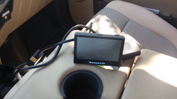

    Have to use a tuner to totally reprogram the truck. There's a few different ones but I went with the sct. Just plugs in under the dash like a Ford garage would do with a computer. 1439669761905.jpg

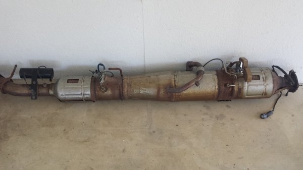

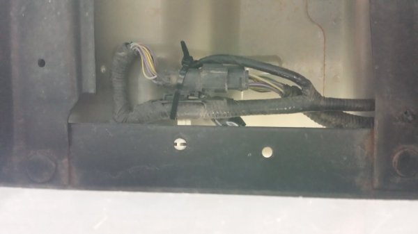

    Correct. You have to tune the truck first and that will disable all dpf, scr, and egr sensors. I just taped the ends up and tied them off with zip ties. There are 12 total no longer in use between on the frame and under the hood. You can see the ones easily on top of the dpf canister now that it's out. 1439669931773.jpg 1439670181812.jpg

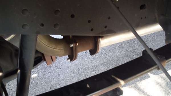

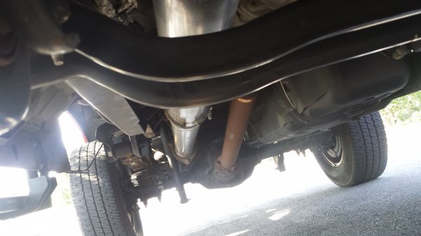

    All done! Went well and everything works exactly like it should! Standing in front it's no louder at idle and the smoke is very minimal which is what I wanted.. Definitely has a rumble when you stand by the tip now that it didn't have before. The biggest difference is how loud the turbo is - sounds great! I'm looking forward to a few weeks of driving to see what kind of mileage gains I experience.
    The finished exhaust! 4" pipe back to the factory muffler. 1439670543407.jpg 1439670637188.jpg

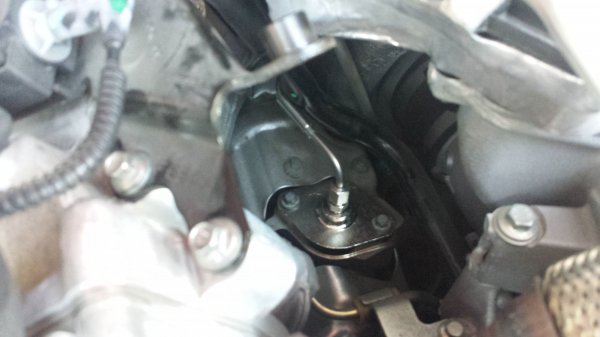

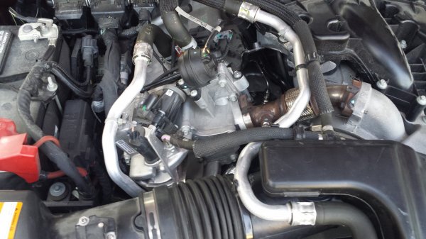

    Forgot the under hood pic of the egr plates and probe. The lower plate has an egt probe that we ran through the firewall where it connects with the tuner to monitor egt temps. 1439680062179.jpg 1439680111286.jpg 1439680183948.jpg
