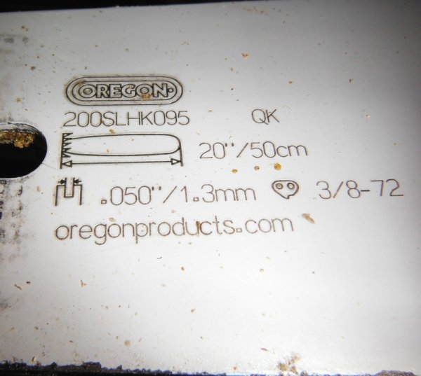

    You said they put the 3/8" Now what is the gauge, (width of the bar grove width) My guess is .050"
    You will need to know the size because you changed from the .325 to the 3/8". Also when yo buy a rim sprocket
    you gotta know the bar numbers . BEWARE: Most will want to sell you the .325 x .058, the stock bar & chain set up. .
    Can you get a close up picture of the bar where the numbers are?
    Here's mine: 20 " bar , gauge = .050 Pitch 3/8" 72 Drive links.
