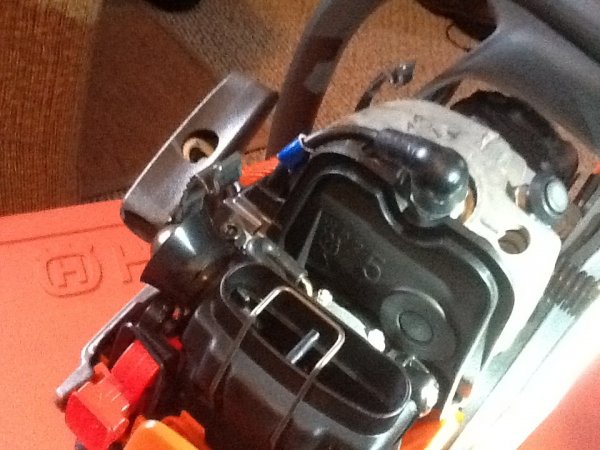

    Almost all saws have a spot for preheated air in the winter?

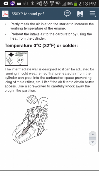

    Not sure on your 359, but all my saws have some type of air preheating intake. The 55 Rancher I have has one, as well as my 550xp and 545.
    I'm gonna look up your manual.
    Here is a Screen shot from the 550 and 545 and they are Autotune.

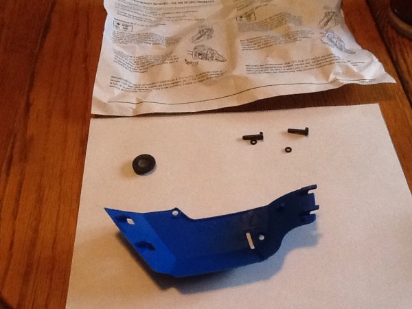

    Here is the update:
    On the Stihl 290 there is a plastic divider that I can rotate to let air from the jug into the air cleaner area to prevent icing. The dealer sent me the parts needed for the 550. Since the 550xp is pulling air in from the starter side and washing over the air filter to keep it clean, it can also pull snow and dump it onto the air filter.
    This blue plastic shield just snaps into place and should be used in loose snow and temps under 32F per the paperwork they sent me, or less than 23F as is stamped on the plastic piece.
    There is also a rubber plug that should be inserted in the plastic divider between the cylinder and the air cleaner. The plug should be removed when below 32F and inserted when above 32F because overheating can damage the engine. I will not do this part unless I need to. The blue plastic shield can snap on and off easy but a black rubber disc will never be found again when I drop it back in the woods or around my work shop area.
    No fricken clue what the screws and rings are for. Maybe same kit for several models of saws. I don't know.

    Also, be sure to do this for Winter weather. For just cold weather use, you can do what's listed below.
    If running in light fluffy snow (bucking)? Then the plastic cover may be needed. But if just using as a limb saw? It won't need it.

    I would imagine they are for securing the blue cover to the recoil cover. The o-rings would go between the cover and the recoil to prevent the cover from rubbing the paint off the recoil? It's all just a guess on my behalf but perhaps the IPL for that saw would show something?

    I might ask next time I am at a dealer. The holes in the cover don't match up to any screws on the recoil cover. It really isn't a deal breaker anyway.
