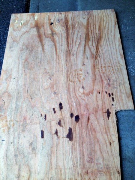

    I did that already with the same results. I will do it again just to double check that I didn't miss anything. Thanks

    Make sure the oil hole on the saw itself doesn't have any junk in it too.

    Did that too..it was clear.

    When you lay the bar on the base/oil plate, make sure the oil hole is lined up and within range of the oil groove.
    20" is the max for that saw and oiler, so you of may not see a lot anyways. After you run it/rev it, pull on the chain (saw shut off and pulling from bottom of bar) and see if the drive links look oiled inside the bar groove.
    If they look oiled, then it's probably getting oiled, it's just the max for that saw.
    Or run the saw with the bar off and clutch cover off. If it's coming from the oiler slot? Then all is well (as long as the hole on the bar lines up).

    The right bar for the saw ?
    Like Dex said, does the bar oil hole lines up with the oil slot on the saw ?

    Thanks guys, that's something I would never have thought to check. That's why I like hanggin around here so much. I checked the location and it is lined up. After my last cleaning it seems ok and is getting oil. I did 4 test runs with the saw placed on plywood and had a decent amount of oil on the wood after. I also had a few good size drips under the clutch when finished but believe this is normal. I will post a pic when I get a chance later today. Thanks again.

    For that saw with a 20", that's perfect. IMO.

    What an excellent way to illustrate what's happening with your saw. Looks good! :yes:
