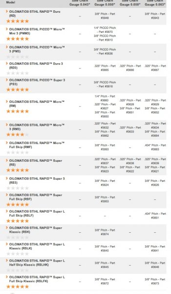

  4. bogydave
    37,220
    Most Stihl dealers have loops on hand & can make what you need.
    Give them a call,
    Stihl has RS in your size : Part # 3637 :

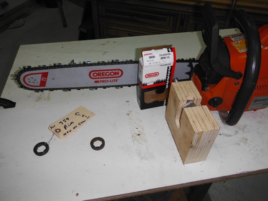

  12. bogydave
    37,220
    If you have the Husqvarna bar, "Farm-tough"
    they are notorious for plugging up at the oil hole on the bar.
    I had to clean mine out frequently. Finally went to an Oregon pro-lite
    Hasn't plugged since I put it on.
