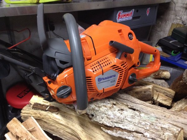

    Got the 555 yesterday after day dreaming about it for to long. Unfortuanately the place I ordered it from forgot to ship me the bar and chain. I was all pumped up to get out this weekend and try it out . I had to talk myself out of just going to the store and buying another bar to hold me over. Oh we'll just have to wait until early next week I guess :(

    Here she sits just a waitn.

    That sure is purdy! !

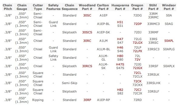

    I would like to pick up another 20 in. Chain for the new saw. Any recommendations on what would be the best all around chain ? I use the file for sharpening.

    Hard to beat Stihl RS for general use. If your bar is 3/8" .050 gauge then the Stihl loop number is 33RS-72.

    +1
    one of the best & fast cutting.
    Oregon full chisel is 72LGX-72 also a decent fast cutting chain,
    Won't find them at the box stores,
    Stihl dealer for RS or saw shop for the Oregon 72LGX & 72LPX
    Stihl RS file size 13/64 & 30° angle
    Husqy & Oregon file size 7/32 & 25° angle
    Some 3/8 x .050 chain brands & part numbers
    Saw Chan 3:8 x .050 Chart.jpg

    Thanks for the info guys. After poking around here for a while I did notice the RS chains come up a lot on here. I'm gonna give one a try. Thanks again :yes:
