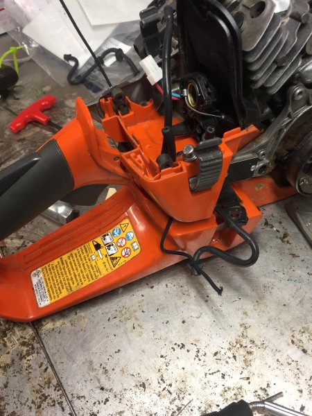

  1. M2theB
    M2theB
    Jan 13, 2017
    3,004
    19,226
    Central Massachusetts
    9B9B08E7-0D0B-4A73-B54C-1C4E1B533B99.jpeg And it not the simplest fuel line to replace. I figured those horns on the tank side were a place to anchor a string around to pull it into the tank. It works

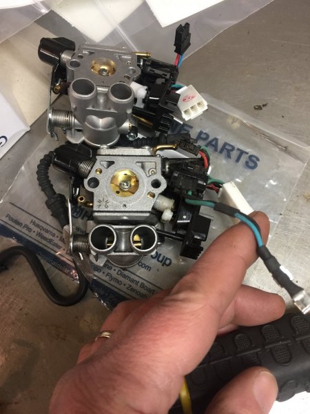

  2. M2theB
    M2theB
    Jan 13, 2017
    3,004
    19,226
    4C198957-B436-49D3-BF87-8D4200C76601.jpeg Again, the only difference I could see between the 7A and the 12 was the fuel nipple.
    The only part I had to transfer from the old carb to the new was the kill switch harness

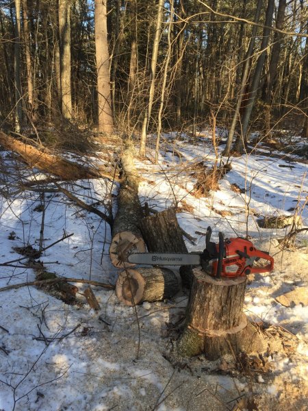

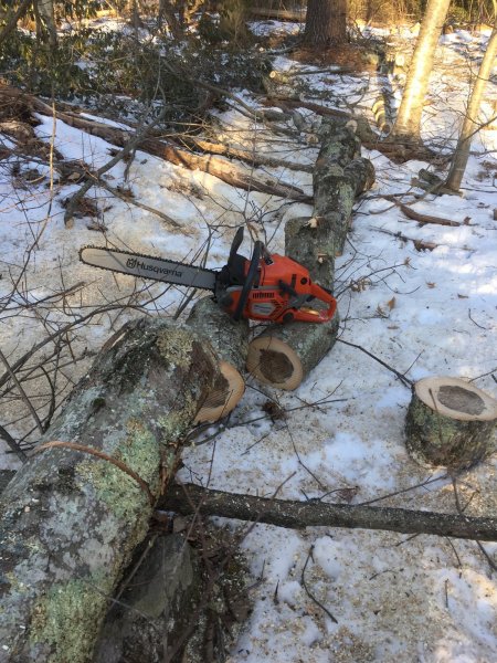

  4. M2theB
    M2theB
    Jan 13, 2017
    3,004
    19,226
    A4A55BF3-BCC2-47C1-9457-CB515D171BBC.jpeg 85600415-2BCA-43F9-9EA7-26F1C561FBFD.jpeg 73340220-1A68-4535-8149-EBA3668CD435.jpeg
    I didn’t want to wait.
    Took this maple.
    Saw ran mint.
    Not a hint of bog or stutter.
    I did empty the tank. I thought that was a little quick. But I didn’t top it off after the test cuts either so I went out without a full tank.

  5. RCBS
    RCBS
    Jan 22, 2016
    6,275
    31,119
    Over here
    Good news!
    Any gaskets that need to be ordered with the carb?
    Hammy and M2theB like this.
  6. M2theB
    M2theB
    Jan 13, 2017
    3,004
    19,226
    Negative. Marry’s to the intake boot
    Hammy and RCBS like this.
