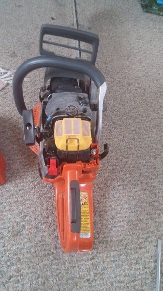

    Are there any aftermarket 550xp air filters available? I just kinda think the factory one that came on my saw looks look its not gona do well. Seems pretty thin, i like the filter setup on my 372 alot better.

    I don't disagree with you and I have a 550XP......... I have seen this highly debated but have never really come to the conclusion that it is an issue yet. I guess when I figure it out it will be to late :popcorn:

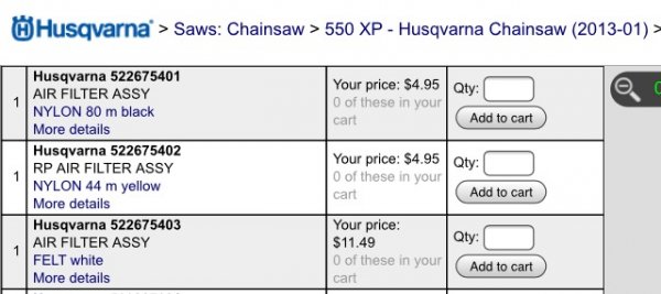

    Did quite a bit of cutting with a 550xp I had. Never had a problem with the air filter. In fact..after a full day of cutting..there would only be a chip or two in the whole air filter area !
    Keep your chains sharp. Make chips..not dust ;)

    Honestly I tear my saw down and clean it up after almost every cutting session and in all of those times with both a 555 and a 550XP I have yet to see any evidence that I have stuff getting through the filters. If I cut a lot in dry dusty conditions or I wasn't on top of keeping a chain sharp (lots of other problems caused by that) I would be a lot more concerned about it than I am.

    Thank you guys for the info and the part number for the flocked filter, very helpful it seems like the nylon filter is meebe a little better than im giving it credit for.

    Great info right there I may have to order one for a trial! Thanks

    I've run the yellow mesh filter in my 346 for years I haven't seen any fines get past the filter into the intake. They seem to work good enough.

    I've ran them both & couldn't tell the difference. The flocked is harder to clean. They say to run the nylon if you're having trouble with icing.

    My 550 actually came with the flocked filter, but due to seeing fines in the intake boot, I switched to the nylon. Not enough cutting time yet to see if there is a difference.

    The flocked should filter better than the mesh. Did you try the oring mod or try some grease on the intake?
