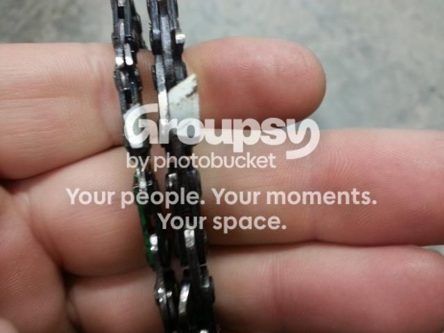

    Here are some pictures of picco and regular 3/8''.
    I laid the picco over the regular 3/8 in this pic.
    Side by side
    Side shot
