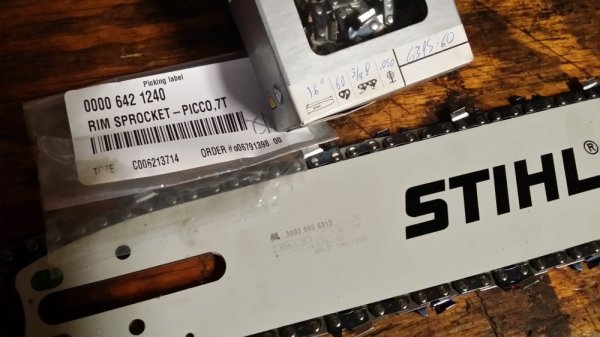

    MasterMech will probably provide the part number shortly. If not, I will in a bit.

    The 16" 3/8 bar oem # is 3003 000 6313. The chain I havent found yet. Ps3 60dl 3/8 .050?
  5. DexterDay
    DexterDay Administrator
    12,411
    31,637
    Northeast Oh
    Rim is 0000 642 1240
    Chain is 63 PS - 60
    Bar is 3003 000 6313 (what you posted)

    Part # on the chain Dex? Ive found the bar and sprocket but no# for the chain

    Because there isn't one. ;) I've never seen a 60 link loop in a retail box. (Does not mean it doesn't exist but....)
    Dex was nice enough to snap a pic with the part #'s for ya, but start reading here for the orginal run of info. Explains why Picco chain doesn't fit properly on standard 3/8 cutting gear and provides part #'s for everything Picco as it pertains to the 3003 mount 16" bar on the 024/026/MS260/MS261.

    Handwriting on that box looks REAL familiar. :sherlock: Thanks Dex! :handshake:
