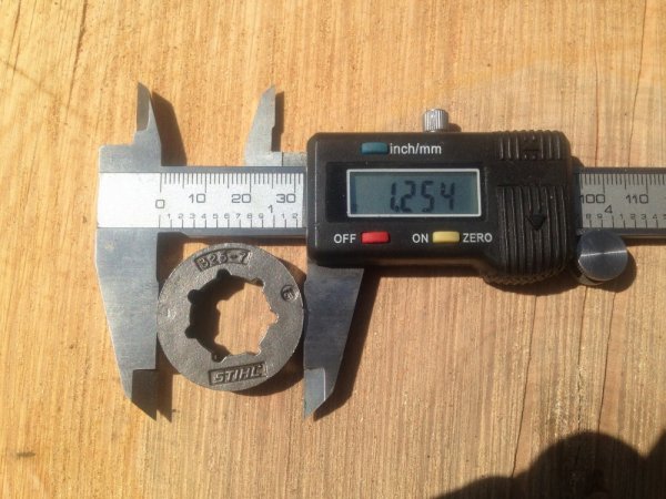

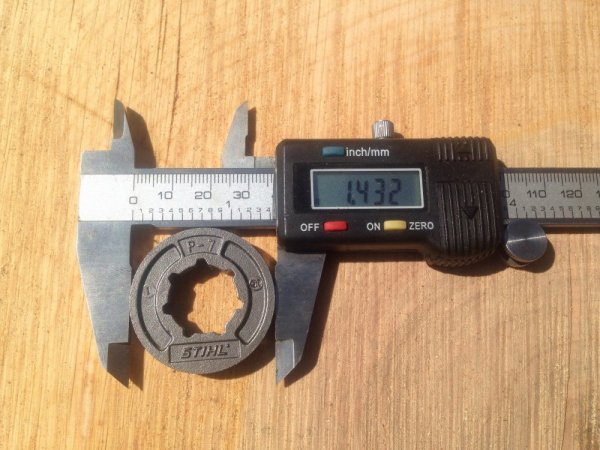

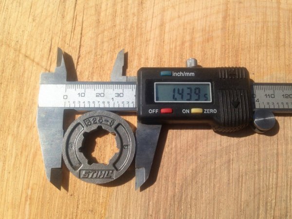

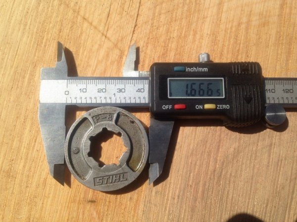

    The sprocket sizes:

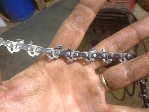

    PS3 in it's ultimate form...
    Notice I did not remove much tooth like on a standard 3/8 chain... There was good reason for that...;)

    Somehow I missed this. I go to about 25° top plate when square filing. I'm not in the normal range for work chain but like how it works for me and my use.
